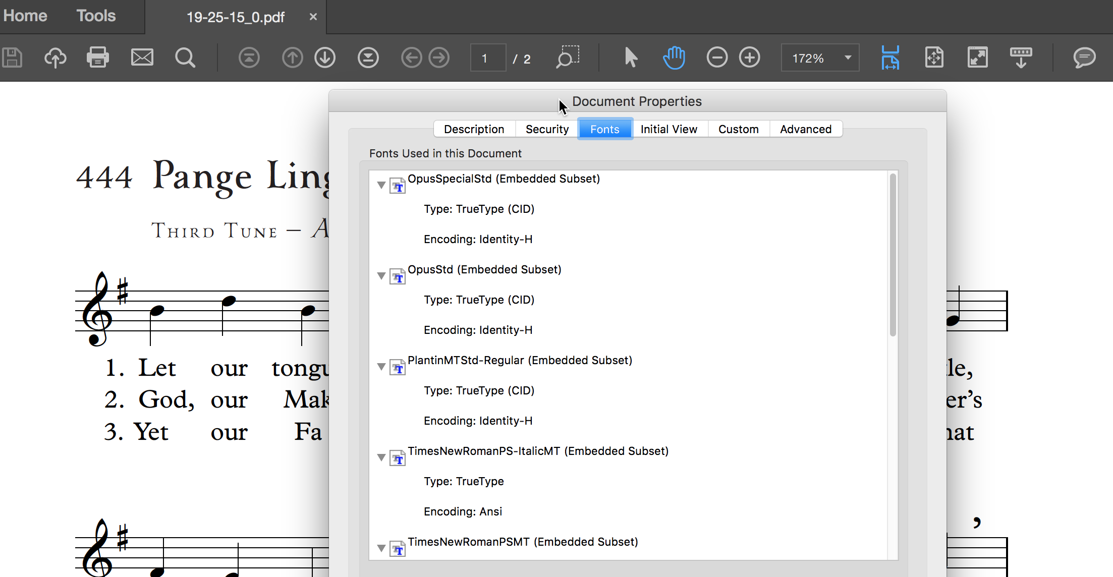

You definitely have embedded the PlantinMTStd-Regular as shown as an Embedded Subset in this screen capture of the Font Properties in Acrobat:
PlantinMTStd-Italic is not listed as a used font in that particular file.

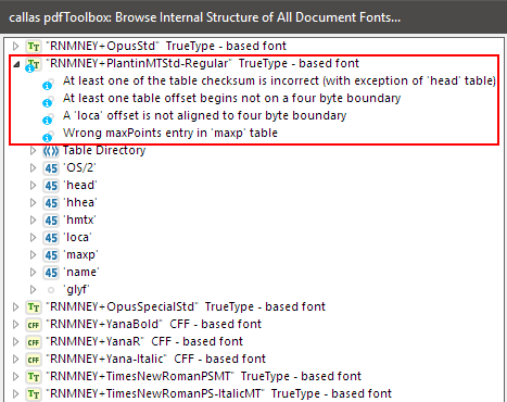

Looks like an encoding issue to me...Here's what pdfToolbox says about the actual embedding.
I can open that PDF, refry it and the errors don't occur. If the music and stanzas were produced in Sibelius, I would likely just convert the fonts to curves and be done with it. You will not be able to do much better at another POD. It is possible BookBaby is using better equipment/workflow, but it's been a while since I used them. They do cost more. But, like I mentioned, I would just take those Sibelius PDFs and convert to curves and make the single black plate if that's what they want.

Aside from a phantom italic style from their so-called preflight, the problem of encoding does exist at their end.
Just converting those Sibelius pdfs to curves resolves the issue and it can go to print.

When you say “encoding error” does that mean I did something wrong?
Valorous Hero ,
Jan 02, 2018 Jan 02, 2018
Hello ceencha,
No, I don't think you did something wrong. But the offsets in the font tables can cause issues if a pdf is not used in a pdf workflow/rip process. Acrobat (or Reader) itself can suss things out when printing, though non-Adobe RIPs and or workflows at a print establishment can misinterpret the encoding.
As regards converting text to curves. It is a stop-gap, more or less extreme solution to the problem. It shouldn't be used willy-nilly as part of a modern normal workflow (which many/most PODs do not have). Mainly at the print device everything is fine as long as in the PDF it looks correct. It does slow down processing of the PDF because of the shear number of path instructions. For a PDF meant for on-screen usage, the PDF is slower to view but there is also the issue of once fonts are converted to curves, they (the fonts) loose all "hinting instructions" which smooth the on-screen appearance.

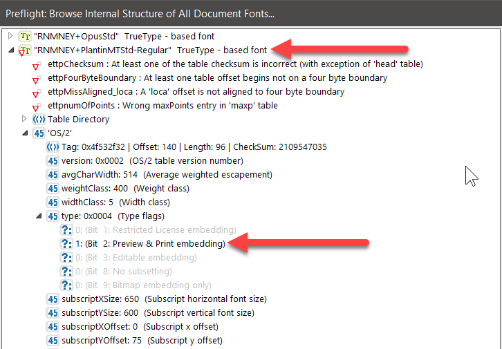

Our analysis was done on the two pages of the PDF file that you provided to us. If you provide me with the entire PDF file, we can ascertain what is going on. For the two pages you provided, there was no PlantinMTStd-Italic font used.
For the PlantinMTStd-Regular font that was embedded in the PDF file, analysis of the embedded font showed that it certainly has privileges for Preview and Print per below. Preview and Print embedding privileges are exactly what you need for embedding fonts in a PDF file for viewing and printing.
Maybe in the other pages of this file there are other font subsets that are problematic? That why we ask you to let us look at the entire file and on that basis, we may need to have a serious discussion with these “technicians.”
