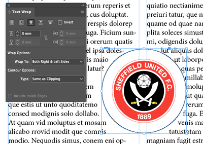

When I turn on text wrap for an image frame, it seems the wrap is applied to the content inside the image frame and not the actual frame - even when I specifically select the frame.
That's fine, except when the content inside the frame doesn't entirely fill the frame (again, check the vid to see why this sux).
My workaround is that I have to select the frame contents (SHIFT+ESC), cut it (CTRL+X), then set the text wrap settings to the empty frame... Then paste my image back into the box with "Paste into" (CTRL+ALT+V) so it's exactly where it was before I cut it.
This doesn't seem normal. Just dumb and cumbersome (Dumbersome?). Is it a bug? Or a weird setting?

You need to select GRAPHIC FRAME for Contour Options - instead of the default value - SAME AS CLIPPING:
When you place an image into it is very normal looking and as expected.
Reset the Text Wrap
 Then it changes to as Clipping
Cut out the image again and paste into
And it is still as Clipping but it looks normal
 Looks like buggy behaviour to me.
As the last screenshot shows the same settings for the text wrap, yet the only difference is the Paste Into.
On the previous if you change the Text Wrap on and off - it shows 'incorrectly'.
Hope that clears it up.

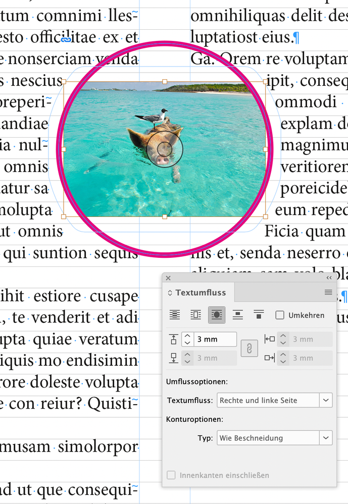

Hi @mogsta ,
I see the issue as well with my German InDesign 2025 v20.3 on macOS.
After placing an image to a circle and selecting the circle ( not the image inside ) , Text Wrap's third button from left applies the wrap to the image and not to the circle.
This behavior could yield to a very strange result like that. From the same object some screenshots:
Wrap expanded to 3 mm:
Image selected inside the frame:
