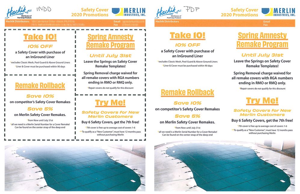

Hello, I'm having an issue with color matching in some of my documents. Specifically, I have a swatch that is being used for some object fills, text colors and text underlines. Everything looks fine on screen but when I print, the text comes out a different color. The photo below isn't great but you should be able to see the text edges over the underline. They both use the exact same swatch (in fact the underline is set to "text color") and I double checked to make sure that the text tint was at 100%. I've attached the InDesign file for your perusal.

I printed out the document from a PDF and scanned both in so the issue is clearer. Take a look, what do you think?

Here's a full sheet comparison of PDF and INDD printing so you can better see the issue. doc08615320200715102150_002.jpg

It's not a toner issue. If you look closely at the image in the OP you can clearly see that the orange text is a different shade from the underlines set to text color. But, as requested I printed out a PDF just to make sure. INDD and PDF print comparisonINDD and PDF print comparison

Composite print drivers can have problems with color managing CMYK color and live transparency. If it’s not a driver issue you would see a color difference in Acrobat when you preview the PDF.
Try exporting to flattened RGB by setting Compatibility to Acrobat 4, and the Destination to Document RGB. Then from the Acrobat Print>Advanced Print Setup check Print As Image

While I have no doubt that your method would achieve for the most part the results I'm looking for, it's pretty hacky and unsustainable. Not to mention printing text as an image looks awful. I did try some other things based on your observations, though, and I can safely say that converting the swatch to RGB and removing transparency do not fix the issue. What's weird is that other documents that I copied the header out of to create this document print fine.
Jul 15, 2020 Jul 15, 2020
If that’s the case maybe there is a corruption in the document, but then it is printing ok from my postscript RIP driver, which seems to eliminate a document corruption.
Any print driver has to color manage and RIP a page to rasters for output, the print as image "hack" is simply controlling that in advance. It might slow things down, but the Print As Image DPI resolution could be set to match the printer’s output resolution. It would at least tell you whether the problem is with the InDesign document or the print driver.

Yeah, you're probably right, and this printer has always given me trouble. The weirdest thing is that the header is copied directly from another InDesign document that doesn't exhibit this issue.
It looks to me like the driver is color managing graphic fills differently than text—the underlines and header bar are printing differently than the text. This has come up before where a driver CMs graphics, text, and images differently and that’s why print as image often works. Is the driver up-to-date?
