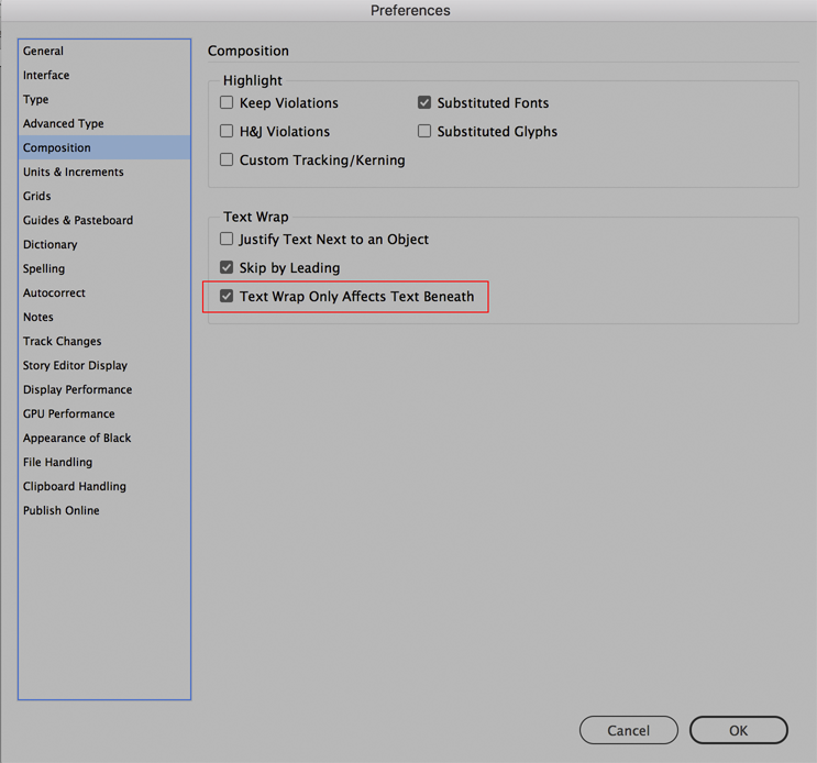

check this preference for each document:
Jul 09, 2018 Jul 09, 2018
Good god, NO! That is a legacy setting for converted Quark documents and should, IMO, NEVER be used.
Without seeing the documents it's practically impossible to diagnose what's going on here. If the OP would like to put them in a dropbox folder and post a link here, I'm sure someone can figure it out in a couple of minutes.

Of course, but that option determines the different behavior of the text wrap...

Well, if by check you meant, check to be sure it’s off, I agree, but you have it enabled in the screenshot.

Yes, I meant as error...

I did not think of it until you said this was a legacy setting for documents converted from quark, it was converted.  Sorry, I did not remember that until you said it.

That solved my problem, thank you very much.
Also, I would like to thank Bob Levine as well.  I did not mention it in my original post, but the 11 x 17 template had originally been converted from quark, I did not think of that until Bob mentioned it.
