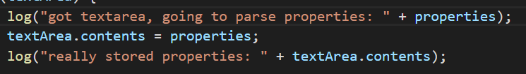

I have a weird issue. I'm updating a textArea.contents with a string, but when I get it back, is not complete... and the amount of stored characters seems to vary randomly...
Here is the code:
And one output as example:
Any Idea what may be causing this? This is only happening on a particular document from a client, any new document we create this works just fine.

"Here is the code..." I tried copying it into the ExtendScript Editor but it did not accept an image. We  cannot test it that way.

rollwhistler  wrote
… I'm updating a textArea.contents with a string, but when I get it back, is not complete... and the amount of stored characters seems to vary randomly...
That may be not randomly at all. 😉
If you ask for textFrame.contents you'll get exactly the contents that is visible in the text frame.
If by any chance it is overset—you added contents before, overset would be likely—you better address the story of the text frame.
textFrame.parentStory.contents

Oh! seems reasonable :-), but sometimes it shortens the string much more than on the example I provided, and the textFrame is dinamically created and hidden, so it shouldn't change its size.
But you probably set me on the good track, I'll make a couple of tests and come back to mark the answer as correct if its my case.
