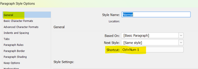

I have created a copy of the main body PS and set it to bear no indent. Trying to make things quicker, I applied it as "Next Style" to the various Headings used in the Preface, hoping that it would automatically fix all of them. It did not. There are a few reasons I think that why that may be but I am not sure. Is it normal for this to behave like this?
I have also set the next style for the no-indent body to be its indented version but, upon pressing Return, it didn't work. This I really do not know why. My intuition is that it may have to do with parenting, the no-indent being a copy of the indent one, but that may be unrelated.
Any idea?

I've had similar poor luck with "Next style" settings but have just never taken the time to explore; I just apply the proper para style. BTW, here's a hint: I set a keyboard shortcut to all my frequently used para styles, so as I go through the text, I only have to select the paragraphs in question and press the keyboard shortcut. To create the shortcuts, edit your para styles, and on the first screen you'll see where to set this up (see below).
