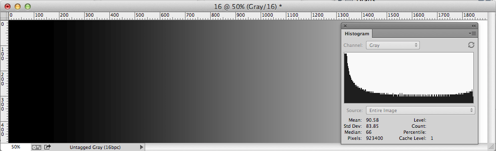

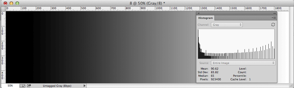

If you edit in 8-bit without using an adjustment layer 16-bits can have an advantage—the image's gray levels won't degrade. Here I've made a big levels adjustment on an 8-bit and 16-bit gradient and you can see the missing gray

If you edit in 8-bit without using an adjustment layer 16-bits can have an advantage—the image's gray levels won't degrade. Here I've made a big levels adjustment on an 8-bit and 16-bit gradient and you can see the missing gray levels in the 8-bit version.
