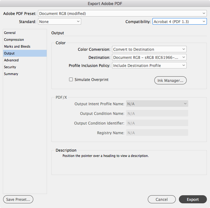

If you are printing to an RGB driven composite printer, export the document to your document RGB space (sRGB in your case). Set your Output tab to this:
When you print the PDF from Acrobat check Advanced>Print as Image.
If the document is going to an offset printer, do not use the above Output settings—for offset use a PDF/X preset
