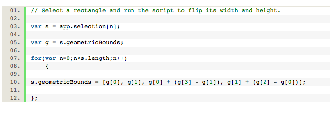

This works great on a single selection.
I’m attempting to loop it and not having any luck, so as to grab multiple selections and have it work on all selected.
The below snippet throws the following error (screenshot below):
// Select a rectangle and run the script to flip its width and height.
var s = app.selection;
var g = s.geometricBounds;
for(var n=0;n<s.length;n++)
s.geometricBounds = [g[0], g[1], g[0] + (g[3] - g[1]), g[1] + (g[2] - g[0])];

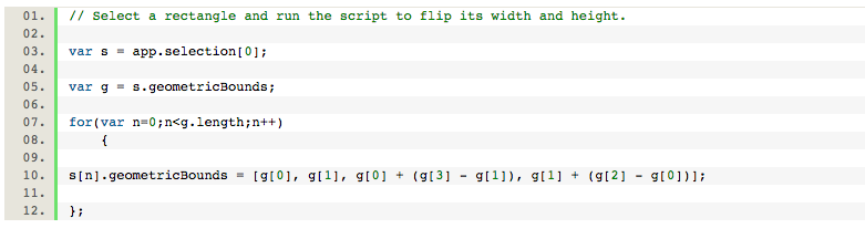

Also tried the below, with the following error (screenshot below).
But previously, without the “” in the 10th line, after the “s”, it threw no errors, but only affected 1 selection in a group of selected frames.
Seems I’m getting close, but don’t know enough about extend script, or looping, to bring it home.

Contributor ,
May 07, 2019 May 07, 2019
    In your first try, you used s.length.  selection is a single object. so it does not have length property.
     In your 2nd try, you used g.length.  g is geometric bounds and the selection is a single object but you used s.  so its threw error.
     Process :
     1. Selection should be multiple. ie., Rectangle
     2. loop it (rectangle) and proceed your flow.
     var s = app.selection;    // Selection of multiple rectangle
     for(var sCnt = 0; sCnt < s.length; sCnt++)
         var cObj = s[sCnt];
         var g = cObj.geometricBounds;
         cObj.geometricBounds = [g[0], g[1], g[0] + (g[3] - g[1]), g[1] + (g[2] - g[0])];
    Try this..
