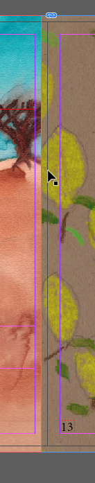

If I leave facing pages checked it looks terrible because the bleed overlaps each page as in the screenshot below
To summarize my problem:
If I use Facing Pages (which I would prefer for layout) I get good page numbers and bad bleed overlap and no way to export individual pages for printer.

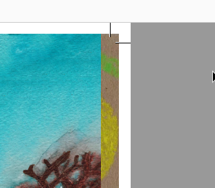

1- If I use facing pages in InDesign then my left page (12 in the example above) has the bleed from page 13 past the crop marks: here is a blank white page left and sky background page right from PDF export (I think I exported as 2up but even single pages have the same bleed issue)
2017-06-01 00_57_15-Collection 1c.pdf - Adobe Acrobat Pro DC.png  2017-06-01 00_55_50-Collection 1c.pdf - Adobe Acrobat Pro DC.png
