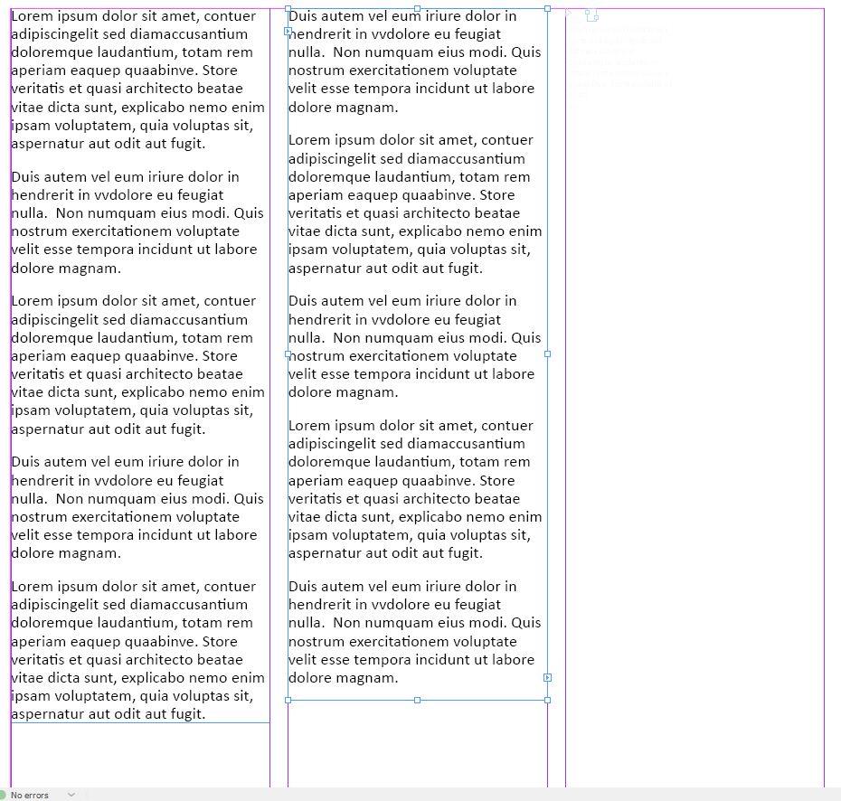

I have a question about text frames in InDesign. It should probably be easily solvable, but for some reason, I can't seem to find the solution. I am working with a template that uses multiple columns and threading text. Now I want to split the columns into separate text frames, so I can change the height of each column individually. Is there an easy way to do this? I added a picture of how it looks now. Screenshot 2022-04-17 131328.jpg

Unfortunately, there is no way to automatically split a multiple columns frame into multiple one column frames. You have to do it manully : resize the existing frame, create 2 other frames then thread them. Maybe a script exists, but I don't know it.

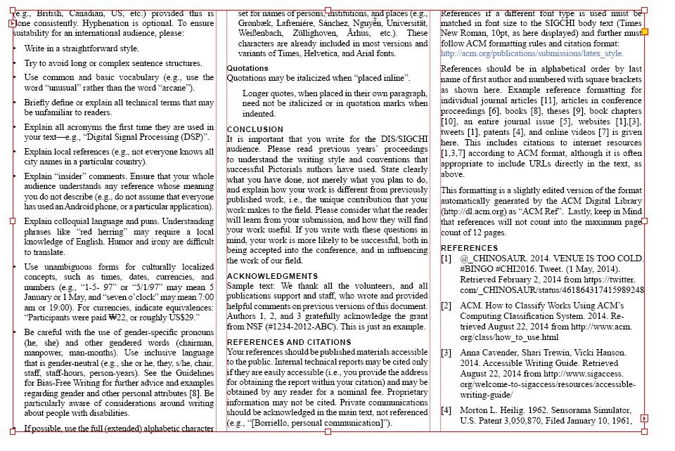

No need to spilt the text columns at all. What you want to do is change your layout to three individual (but still threaded) text frames of 1 column, as opposed to one text frame that has 3 columns in it.
If your page doesn't currnetly have column guides, add them.

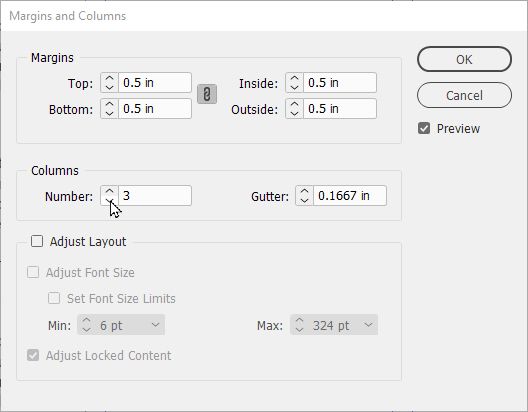

  • 1d.jpgSecond, select the Layout>Margin and Columns menu command to open the dialog box. Move down to the Columns: edit box and change it to 3, then click the OK button. This will make it easier for you to line up the columns and size the width equally.

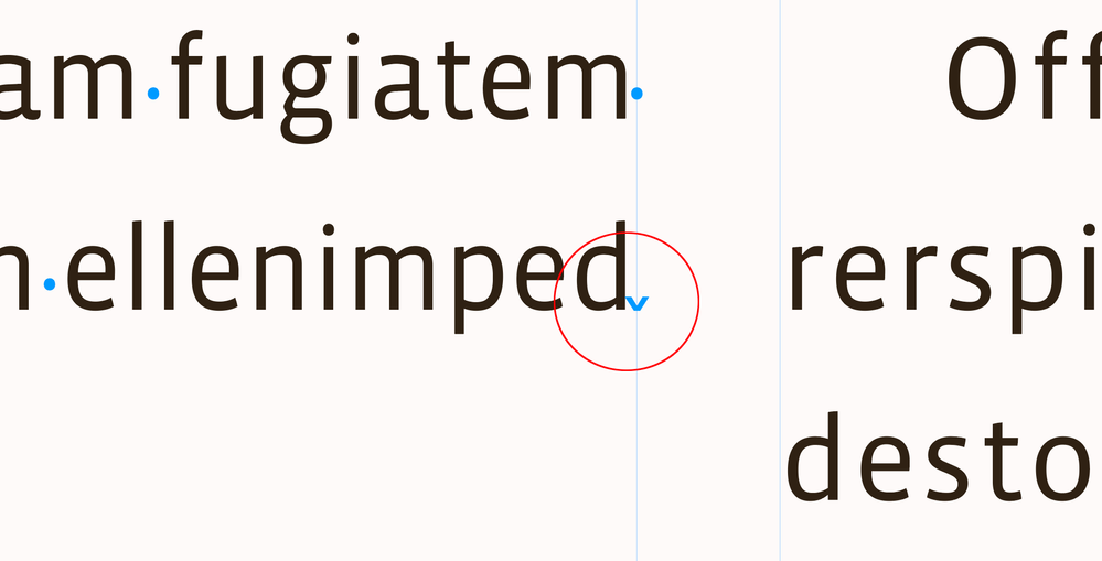

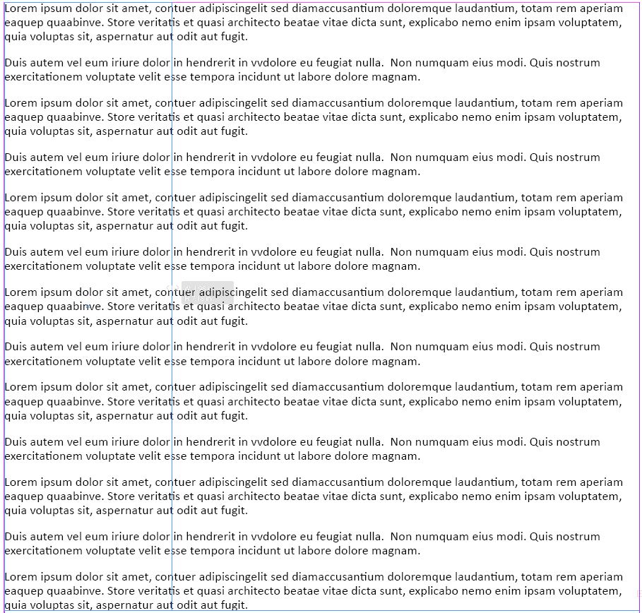

The original post is 3 years old, but another option, which I don’t think was mentioned, would be a Column Break character. There would be some advantages in keeping the 3 column text frame—i.e., you want to change the gutter dimension sometime on the future.

Yeh, the column break is fine, if you are vertically top aligned, I think if it's vertically justified it is not so useful.
One of those nagging feature requests I keep meaning to put in.
