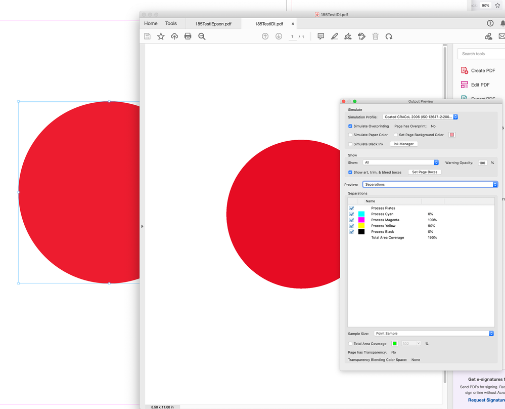

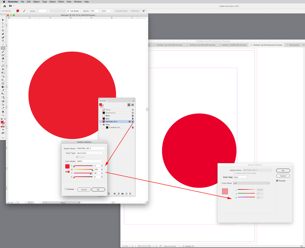

Hi @U16B6 , starting with CS6 the InDesign Pantone + Solid ink books are defined as Lab Spots. That change helped clarify the difference between an actual spot color outputting to a separate press plate and a CMYK process simulation of the spot ink. There‘s also the Pantone + Bridge swatches which are defined as process CMYK, so unless the job is really outputting to a spot separation, the best approach is not to use spot colors at all.
If you place a file that includes a Pantone named solid ink Spot color, the ID book’s Lab defined swatch gets added to InDesign’s Swatches panel. As long as the linked file is in the document, you can only edit the Color Type. Set it to Process and the output to Document CMYK would be a color managed conversion from Lab space to the document’s CMYK profile.
There has never been a way to edit the color space and values of a swatch that comes in with a placed object, but you  could remove the placed file(s), edit the spot swatch to a CMYK definition, replace the file(s) and get the new CMYK values:

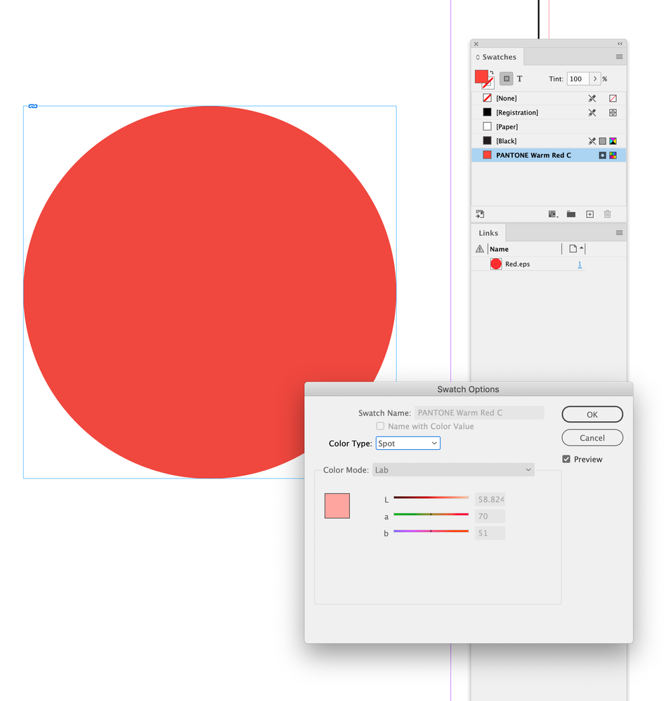

Mar 01, 2022 Mar 01, 2022
You have to watchout for Color Type though. If you want to convert the color to a custom CMYK build in the placed file, and it is using a PANTONE name, you have to convert the Color Type to Process in order to get the CMYK values in ID. If it is left as Spot, InDesign will override the placed file’s spot CMYK definition, and use its Lab defined PANTONE book swatch:
