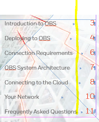

Hello I have a TOC heading style that I am unable to align as I desire.
I would like to have the text aligned agst the yellow line. ... where the 'Frequently Asked Questions' ends.

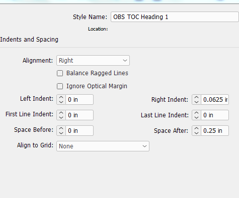

The foll is my toc style settings:
I have tried diff. permutation and combinations, but im unable to wrap my head around as to how I shld get this working.
Any guidance would be greatly appreciated.

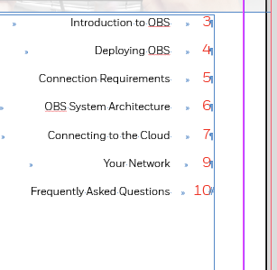

As an alternative to winterm excellent answer (as always), here's a trick that would prevent you to run again a GREP query after updating TOC:
Set your TOC paragraph style aligned to right. Add positive right indent and negative last line indent (i.e. 10mm and -10mm)
In the TOC options, instead of adding a tab between entry and numbering, add a hard return ^n
Then add a character style to numbers. Add a positive vertical shift to it to get the number aligned to entry (12 pt in my example, but you'll have to adjust that)
See example:
