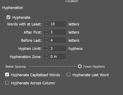

Short line endings are not Widows or Orphans--they are paragraph issues. Some people call them Widows, so I tend to call them "Line Widows".
This is what I do in my main Body style to prevent short endings:
I adjust the number depending on the column width used. If the character count hits mid-word, it still has to follow my hyphenation settings.

I suggest the "All of the Above" opinion, with one caveat.
1) Robert directs you to a post from Eugene suggesting a GREP find-and-replace. I often do it that way, but more often I do as Robert suggests and build it into a body text paragraph style as a GREP style. At other times I will do a find&replace to add non-breaking spaces between the last word and the second-to-last word in a given body text paragraph style.
2) Dave suggests adjusting your hyphenation settings as well, which when set correctly can really improve your rag and minimize runts. His settings look almost exactly like my own.
