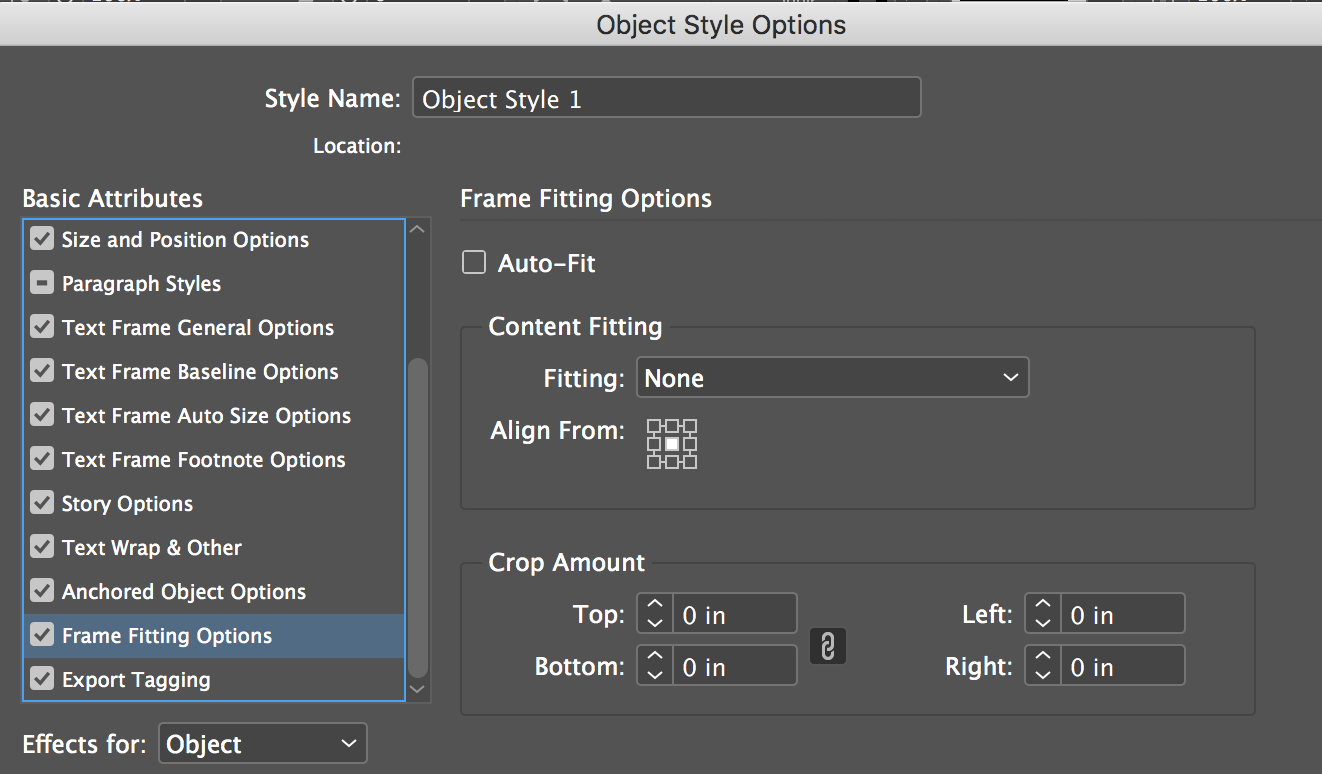

Use Frame Fitting Options:

From the screen Steve showed you, turn on Auto-Fit and set Fitting to Fill Frame Proportionately or Fit Content Proportionally depending on the aspect ratio of the images and the frames. And don't forget to select the center reference point in the proxy, as he is showing you.
~Barb
