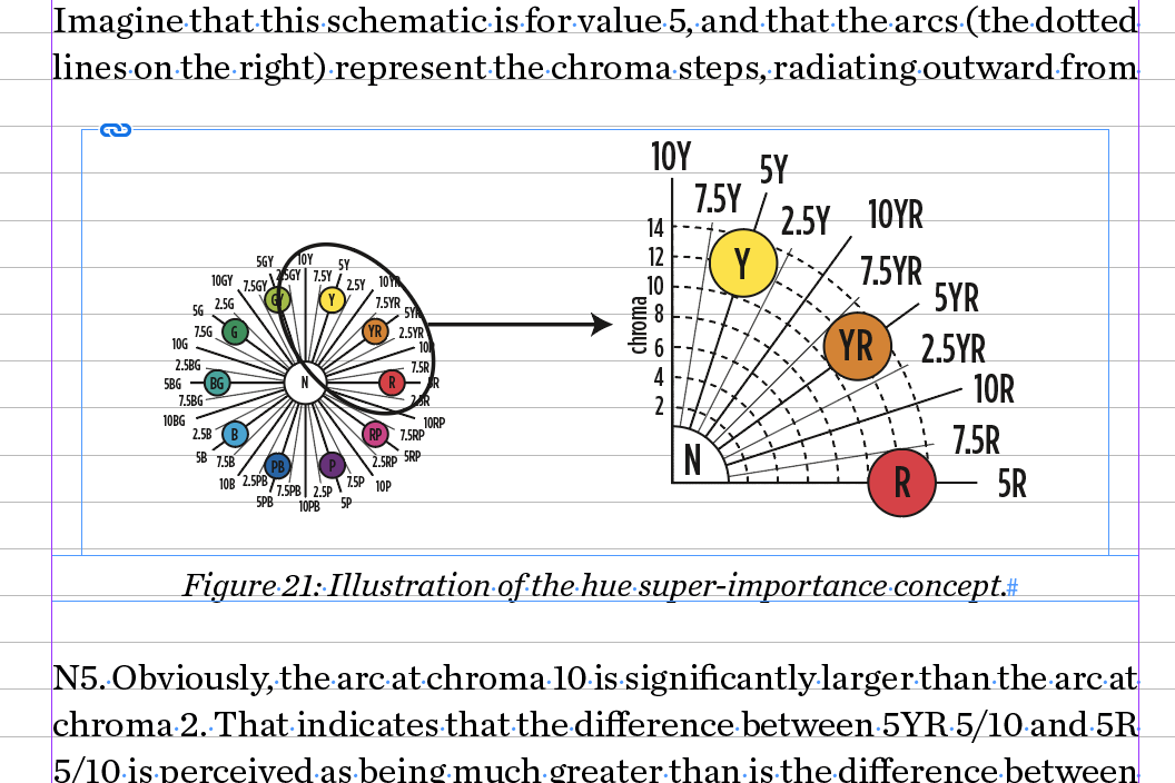

Here is the first one: it was easy to do because there was a natural break int he text that allowed me to simply create my caption with a paragraph style.

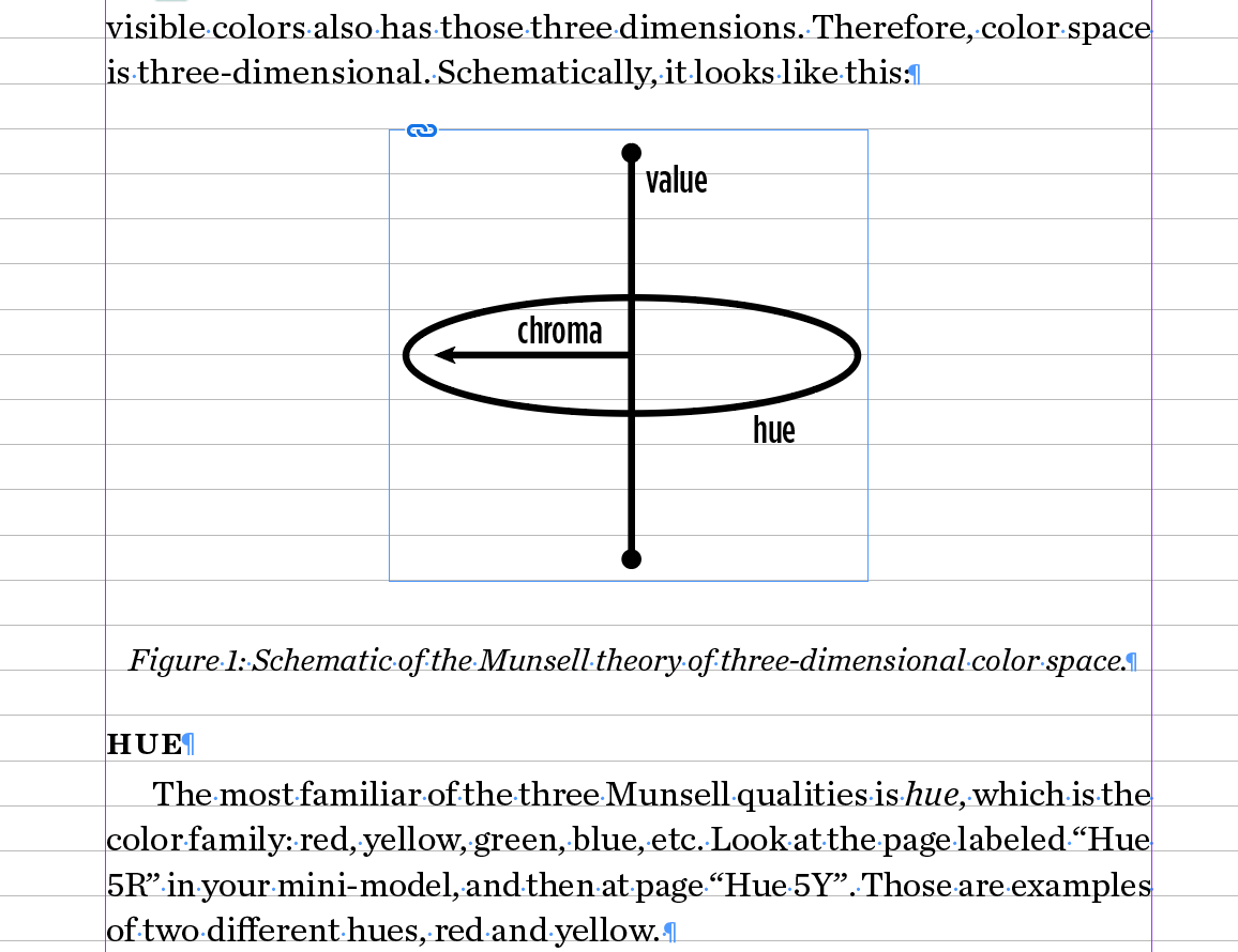

But of course it won't always be that easy: here is an example where the figure and its caption had to be inserted into the middle of a paragraph and so I put the caption inside its own text frame to get the body copy to "jump" the figure + caption combo correctly.
Is this the "right" way to do captions? If so, is there a way to automate the creation of a caption box for text when a new graphic is placed?

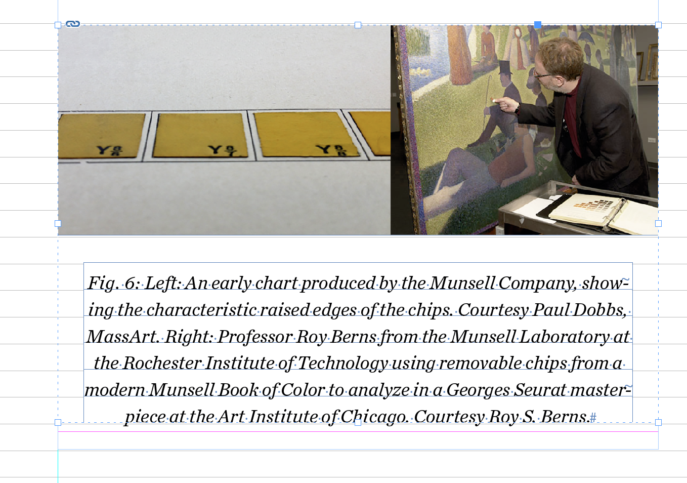

Thanks Barb, that is a good suggestion. As you can see, I ended up the captions a little bit offset from the baseline. Any thought on how to fix that? My paragraph style for captions is "align to grid".

I'm not sure what you mean by "As you can see, I ended up the captions a little bit offset from the baseline"—your caption baselines are snapped to the baseline grid. Did you want them closer to the image? If so, shorten the image slightly (or reduce the text wrap offset below) and then you can move the captions up to the first grid line under the image.
~Barb
