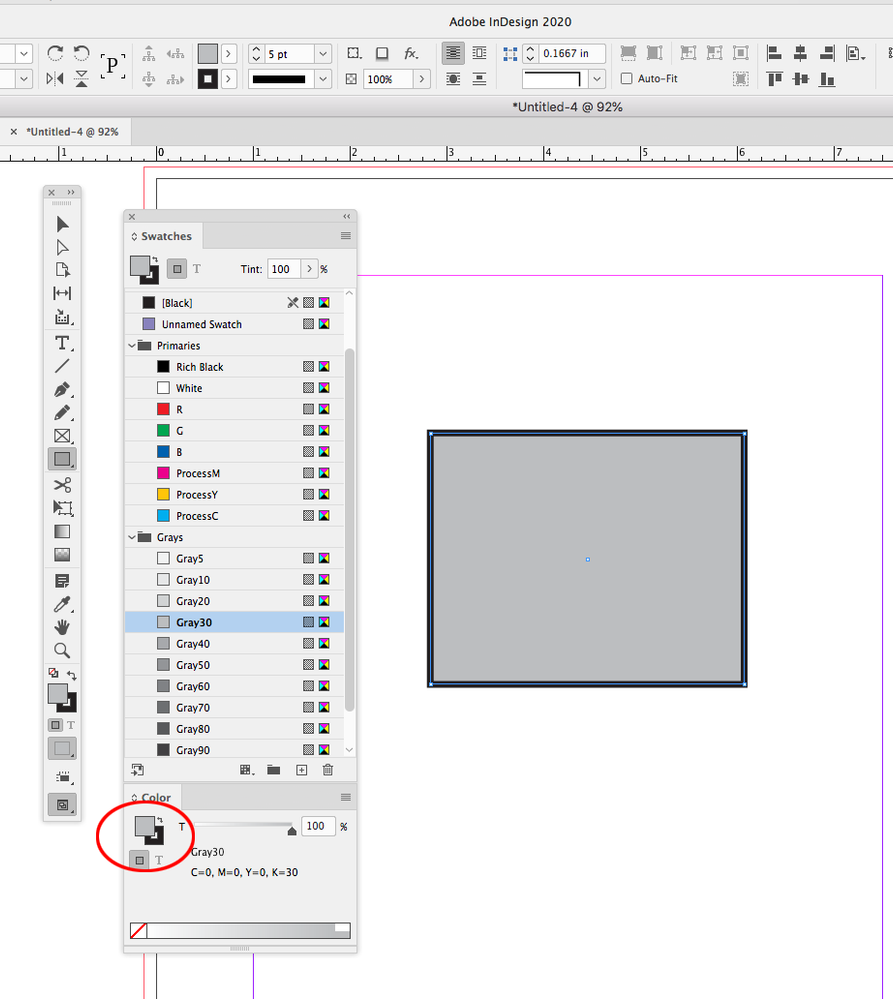

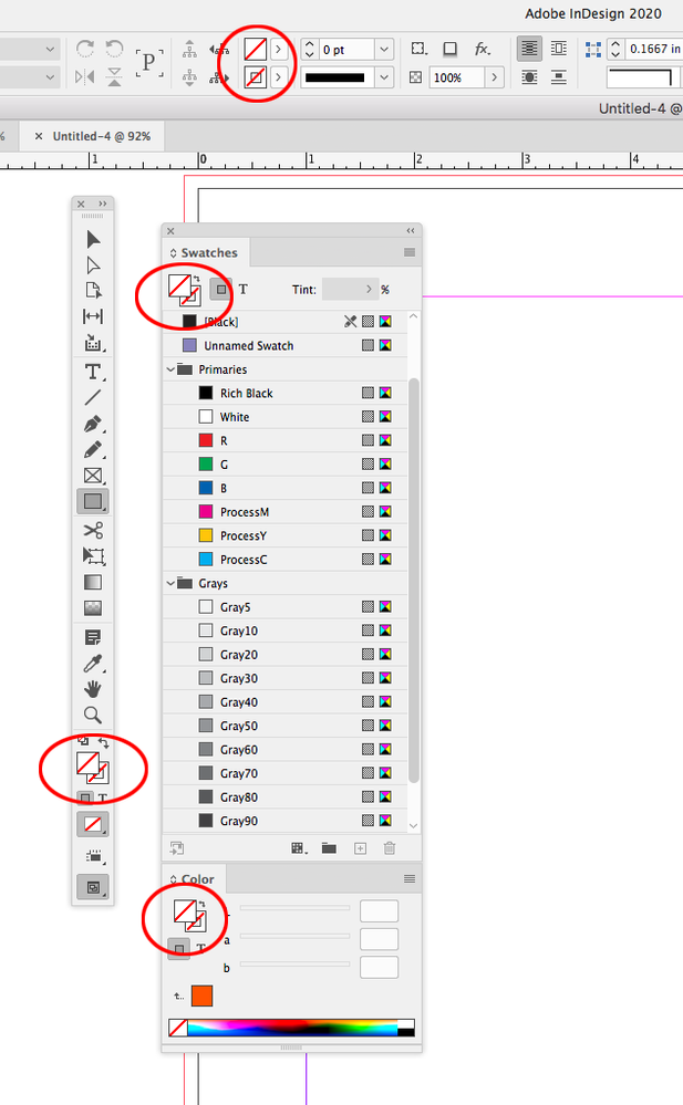

When you create a rectangle the current Fill and Stroke settings are used for the new rectangle. The Fill and Stroke can be set in a number of places and if both are set to [None] there will be no fill or stroke:

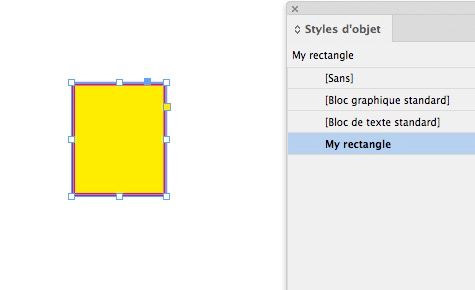

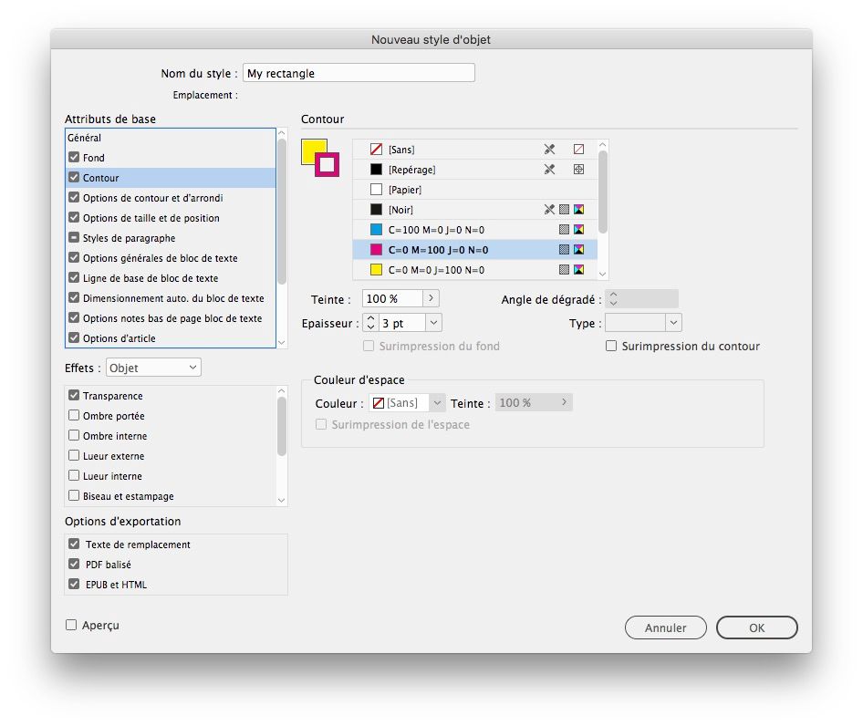

You could make an object style:
Capture d’écran 2020-03-21 à 17.26.30.jpgCapture d’écran 2020-03-21 à 17.26.35.jpgCapture d’écran 2020-03-21 à 17.26.44.jpg
or set stroke color and thickness, and fill color before drawing any rectangle
