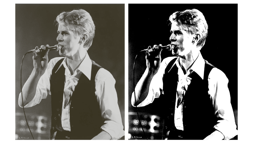

@rob day, the images posted below illustrate the problem much better than the ones I posted before, so please, let's forget them and let's concentrate on this:
This is not from the actual book, but this is just a rough reconstruction made in Photoshop. I picked up this image online and here I use it for educational purposes only. I didn't use it in my work.
What you see on the left roughly represents what I see in Acrobat's simulation and what I expected to get on paper. Note the background, the black there is not really black, but dark gray. Everything looks kind of "calm". Btw only K is used, CMY=0.
What you can see on the right roughly represents what I got on the test-print. It looked nowehere near the simulation. The black was very intensive and everything looked contrasty. Some tiny details (such as wrinkles on the people's faces or on their clothes) somehow got lost. Their faces all looked very pale and they were all "swimming" in this cosmic "black hole". There are not many gray shades between black and white. This reminded me of a photocopy. Note that it was on an uncoated paper and it was K only (CMY=0).
I wonder if this means that the printer pushed the ink density settings too far. I don't know the right term.
I still feel (rightly or wrongly) that the printer messed up something. And now I'm trying to define the problem and to prevent it from happening again.
Thanks
Nov 14, 2022 Nov 14, 2022
Is your monitor calibrated to the output device? If not you cannot rely what you see on your screen.
You got the test print - it's your opportunity to pass or reject it.
If you are rejecting it - then you need to confirm what you expect from the test print. Illustrating how you have here.
It's impossible to know from screenshots and would need to actual print ready PDF files.
If the test print is an actual proof from the press then the print Simulation Profile is wrong.
