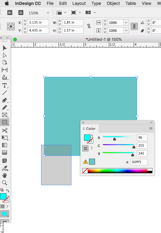

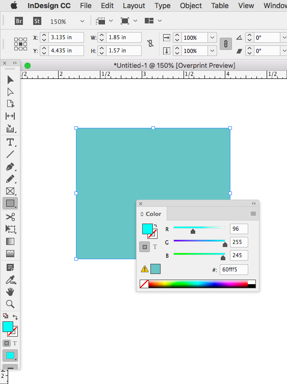

Jan 07, 2020 Jan 07, 2020
An RGB color might still get previewed as it would output to a CMYK device when Overprint is turned on, or there is any transparent object on the page, with the blend space set to CMYK:
