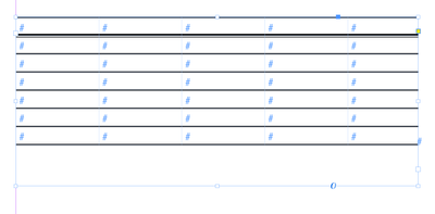

Hello
I imported some tables from Word into Indesign and created some cell styles and some of them seem to be spilling over from where the table should end. Any ideas on how to make them stop where the table ends?
Thanks

Apr 14, 2023 Apr 14, 2023
I was able to duplicate this by adding a wide white stroke on the right side of the table, and setting the stroke drawing order to Row Strokes in Front

Novato ,
MAIS RECENTE
Yes this worked! There was a wide stroke on the right and I didn't show up. Thank you!
