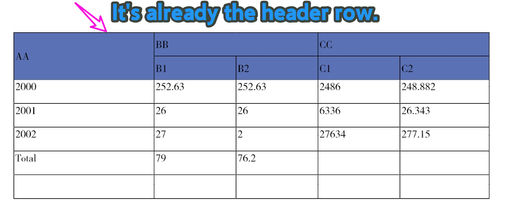

Guide ,
Jul 18, 2025 Jul 18, 2025
If it's already a table header, it will report an error.
Nothing else found.
Still want to be able to execute scripts with table headers already present.
Because sometimes the table header already exists, but I still need to add rows at the top or at the end.

@m1b Hi m1b.
Sorry.
It turns out that the error is not caused by an existing table header.
It was caused by an existing table footer.
You don't need to add the footer, I'll add  table footer later.
Becausetable footer is simple, I add my own easier to control the point.

Hi @m1b
To exclude that the currently selected row is already a table header, I need to convert the header row to a table body row first.
Example : there are alread  2 table header rows.   I am selecting them.  Try the script,  Will pop up: Cannot set row type.
Convert in order:
rows[1] coverto bodyRows,
rows[0] coverto bodyRows.
Is there an error in this listing?

Hi @m1b
It's weird.
The selected line, if it's body, goes to header with no problem.
On the flip side, if it goes to header to body, it says that the row type may not be set.
I tested that May posting directly, and it also fails to go from headRow to bodyRow when spanning rows.
I tried to change duplicateRows(sourceRows);
to: coverHeaderToBody(sourceRows);
without success.
Guide ,
Jul 21, 2025 Jul 21, 2025
Hi @m1b
I still haven't solved the bug : headerRows  converted to bodyRows.
Pop up: You cannot set the row type.
The merger was canceled, but not merged again.

HI @m1b
I'm really frustrated and can't figure it out.
I've tried n types.
The first, converting to the header row is possible.
The second, converting to the body row is not possible.
Hint: This sentence
rows[il.rowType = rowType;
Pop-up: Unable to set row type.
The first: This is feasible,
but the order of the table headers seems to be the opposite of what is customary.
//Convert Body row to header row
function toHeader(sourceRows) {
    // collect all the rows that now *should* be body rows
    var headerRows = [],
        table = sourceRows[0].parent;
    var e = sourceRows.length;
    //That's strange, the header row is rotating backwards? Shouldn't the first row rotate first?
    for (var i = e; i > 0; i--) {
        if (RowTypes.HEADER_ROW !== table.rows[i].rowType)
            headerRows.push(table.rows[i]);
        // convert them to body rows
        var headerRows = convertToRowType(headerRows, RowTypes.HEADER_ROW);
Second:
This is wrong. Pop-up: Unable to set row type.
//Convert all header rows to body rows

Hi @m1b
It seems that most of the issues have been resolved.
The only remaining major bug is: cross-column (spread rows)  to HEADER_ROWS.
Perhaps you could provide detailed comments on your code for splitting and merging the table header rows so that I can study them.
Guide ,

Aug 26, 2025 Aug 26, 2025
@m1b
BODY_ROW can transition to HEADER_ROW.
However
HEADER_ROW cannot transition to BODY_ROW.
 This won't do. I haven't found any issues. Should we modify the code for splitting and merging?
I am trying to get to the bottom of this
Hi @m1b , I get an scripting error when I try to make rows that have cells that have been divided or merged via the UI. You can make rows with divided or merged cells into headers if you construct the table or handle the initial merge or divides via scripting. See the script I posted here.
https://community.adobe.com/t5/indesign-discussions/brainstorming-with-script-how-to-transform-sprea...
Guide ,
@rob day
You need to look at: function “convertToRowType(rows, rowType)”
It appears to only apply to: BODY_ROW to HEADER_ROW.
