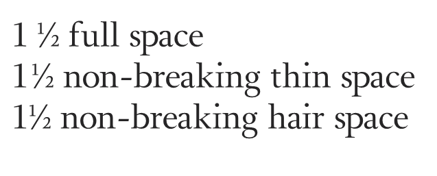

I usually use a non-breaking thin space between the whole number and fraction. But it depends upon the point size in the ingredient list. If the point size is larger than I normally use, then I'll insert a non-breaking hair space. I'm not a fan of zero space between whole numbers and the fraction.

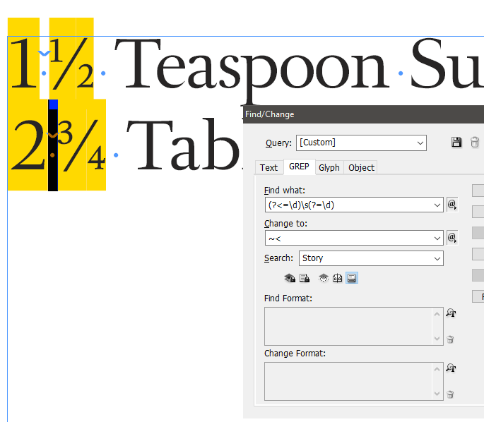

Hi Marina,
To tell the truth, I usually either receive tagged text files that I manipulate via PERL regular expressions, or a Word file that I export to tagged text and do the same.
In ID, it can also be done via GREP find/replace.
I would not suggest a Replace All. It will still take a bit to find, then replace, then find, replace, etc. But it should work.
What the find expression does is look for the presence (pattern) of a digit then space then digit. It doesn't capture the first expression, only the space and digit. Then replaces the space for a thin space and the first digit. It could be further enhanced by not capturing the digit following the space.
Mike

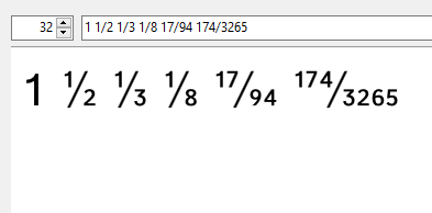

I know the person who created the following two fonts, one a serif, the other a sans serif. Both have arbitrary fractions that work.
https://www.fontsquirrel.com/fonts/kelvinch
https://www.fontsquirrel.com/fonts/cadman
Perhaps one of those two fonts will work for your use.

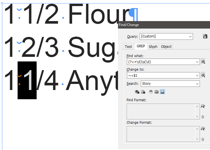

Here's a GREP that only finds the space between numbers...

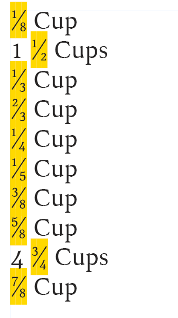

Thanks, Mike. That's so helpful, and I appreciate you taking the time to find some fonts. Alas, neither Kelvinch nor Cadman creates fractions for thirds and eighths, two very common measurements in cooking (1/5 isn't used in cooking; I just have it in there to test a font's ability to make fractions of anything). Here's Kelvinch, a very attractive font:
I'm continuing to look through the offerings at Adobe Fonts, MyFonts, and in my extensive font collection.

Oops. I guess I only looked at the Cadman code. It does do arbitrary fractions.
But Kelvinch, which uses ligatures, does do common (and uncommon) fractions.
Like I mentioned, Cadman does do arbitrary fractions.
If Kelvinch would work for you, I can ask Paul to either insert his fraction code from Cadman into it or offer to do it myself. His license permits me (or whomever) to do it as long as the reserved font name changes so there wouldn't be an issue. It shouldn't take very long to do.
Most foundries do not have the code rolled-in for arbitrary fractions. At best, some have an expanded ligature offering like Kelvinch uses. Most have few fractions using the ligature option. I am sure there are other OpenSource fonts using arbitrary fraction coding. But I wouldn't know where to look on FontSquirrel or Google fonts to narrow them down.

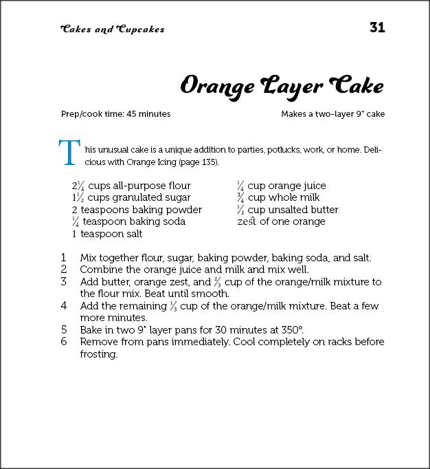

Wow, that looks perfect. After a little troubleshooting, I discovered I'd modified the Ingredient paragraph style with a nested character style, which was preventing Kelvinch from doing fractions. Here it is again, compared with Museo.
I would love it if you were to ask Paul to insert the Cadman fraction code into Kelvinch (or if you were to do it yourself).
I'm going to experiment with using a nested character style so I can have Kelvinch format the fractions, but keep the rest of the ingredient text in Museo. I think the two fonts will coordinate well.
Thank you so very much for taking the time to help me solve this problem!

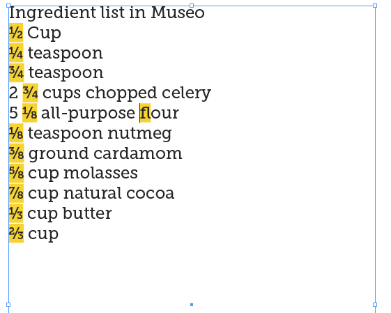

Hi Mike,
Here's the Ingredient style in Museo with a nested Kelvinch character style.
