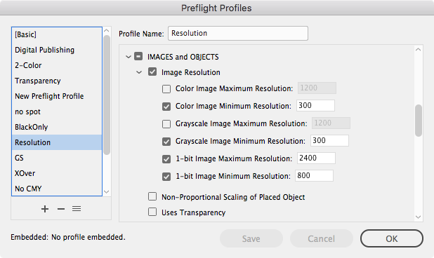

Preflight checks for a ppi resolution threshold, but I don't see away to check for pixel dimensions, which is what the OP is after. The OP can't have an image that's over 2000px x 2000px (4,000,000 pixels). A 2000x2000 pixel image could have any ppi resolution depending on its output dimensions in inches.

Yes the Links panel gives an images's pixel dimension, but Preflight doesn't.
Preflight's IMAGES and OBJECTS>Image Resolution lets you set a threshold for ppi, but that wouldn't help with pixel dimensions. A 2000x2000 pixel image could be10ppi with an output dimension of 200"x200", or it could be 2000ppi with an output dimension of 1"x1"
It would be possible to script — scripting lets you get an image's width and height in inches, and its Effective resolution.

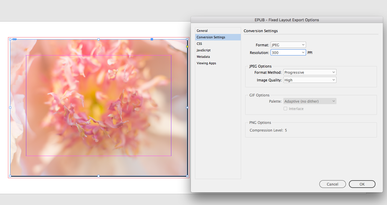

I'm not seeing a problem when I place a .PSD. The exported pixel dimension seems to be correct relative to the page’s inch dimensions.
Here my page dimension is 11" x 8.5" and I'm setting the Resolution to 72ppi
I'm expecting the exported image width to be 792px (11x72=792), which is what I get.
If I set the Resolution to 300ppi I get a 3300px width, so to stay under 4,000,000 I can't use 300ppi when there are full bleed images on an 8.5"x11" page:
