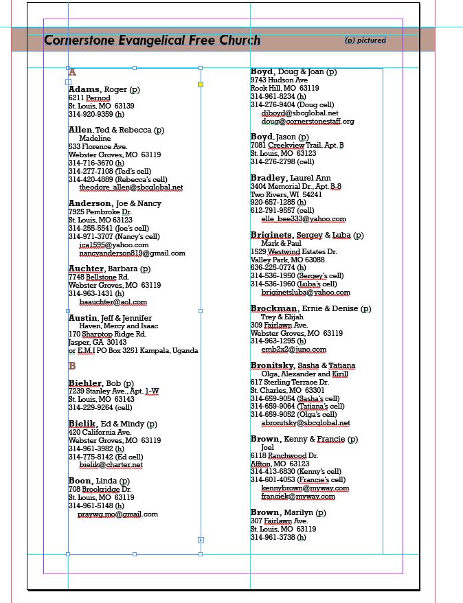

Thanks for all of the replies and the links to plug-ins, etc.  However, being a bit stubborn, as we have done this task before in INDD cs6, we are flustered to recall exactly how we did this, therefore trying to find a solution.
Please see shapshot attached for the layout we have previously done, with the linked/threaded text boxes.dir roster snap.JPG
Just seems we are missing a step in the process to get this accomplished.  We get the data into indd, but will only show the first of the list in the text box.  We can click on the preview and it will flow through each contact individually in the same box, but just unable to get all to flow through.

If you can't remember how you did it, how do you know it was a data merge?

Gee Bob, seems logical to me based on the threaded snapshot.  In addition, we have shared with you that is was via a datamerge, and we have the samples of prior work, just unfortunate we seem to be missing a step of some sort.

As already point out to you, there is no way this was done with InDesign data merge.
You’d have more luck copy/pasting that text with the proper paragraph styling (with next styles used judiciously).
Jan 13, 2017 Jan 13, 2017
davidjstudios wrote:
...seems logical to me based on the threaded snapshot.
Actually, your screenshot shows a result Data Merge can't provide, so Bob's question isn't all that erroneous.
Data Merge's Multiple Record layout features deliver each record in a discreet text frame, cloned from your original one, with as many such clone-frames as data-source records, lain out according to page-fit of the frames-size. (In other words, if 12 copies of your original frame will fit between the margins you set, then you'll get 12 framed records per page.) This results in a very grid-like structure of multiple frames. Conceivably, those frames could subsequently be cut-and-pasted (thus anchored) into threaded frames of your making to establish a "flow," but even then, the frame-per-record scheme would persist, as opposed to the free-flow text depicted in your screenshot.
