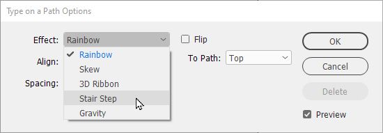

Now's where the fun came in. Get your Text tool,
highlight the letter again and go to the Type>Type on a Path>Options... menu command. In the panel select the Stair Step option in the Effect: options box, then select OK.

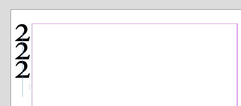

This is where fitting the page number type gets challenging. When you go to, say, page 222, the copy looks like it's
crashed vertically, like the example at right. Working with normal type-fitting tools within InDesign like kerning, tracking and leading didn't change anything except the alignment on the top 2 numbers from left to right.
What finally did work, to some degree, was to effectively double the type size and select the
Small Caps button in the Control Panel, as shown at right. Doing that resulted in the page numbers stacked with just a little bit of space between the numbers like the illustration shown below:
