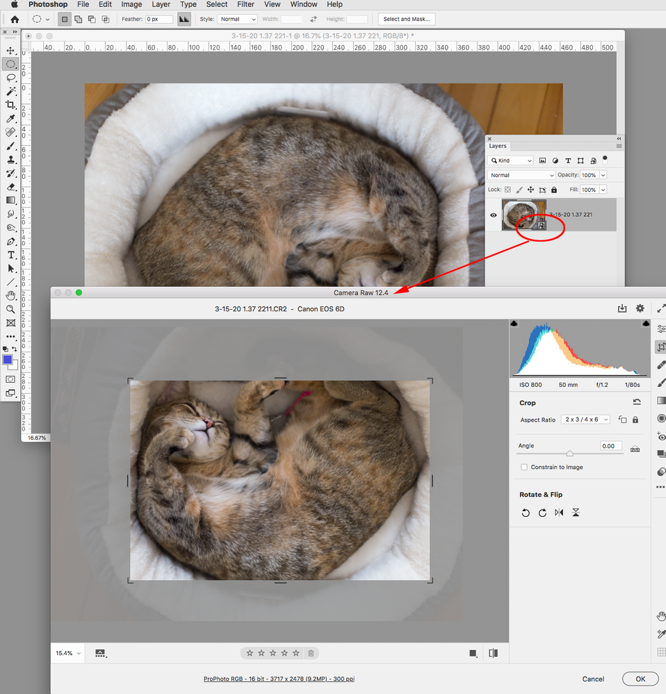

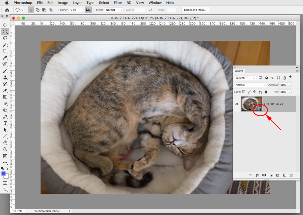

Also, you can’t directly place a RAW file, but you can open RAW files as Smart Objects, which gives you access to the Camera RAW contols in a PSD, which can then be placed in InDesign. The Smart Object approach lets you avoid saving out an extra file for corrections and placing.
In your Camera RAW Preferences check Open in Photoshop as Smart Object. Then when you click Open Object you‘ll get a PSD with a Smart Object layer
Click the Smart Object icon to access and edit the Camera RAW controls:

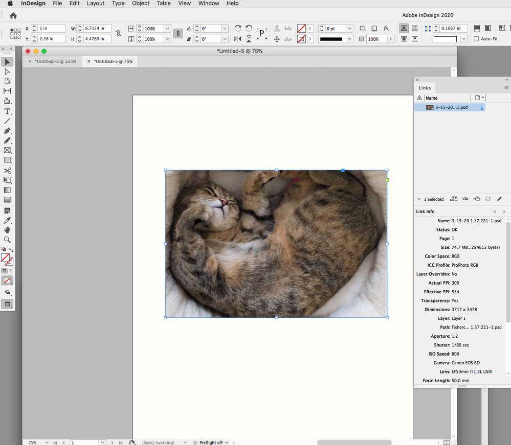

The PSD with the Camera RAW smart layer can be placed directly in InDesign, and if you Edit Original the layer can be edited using the Camera Raw controls:

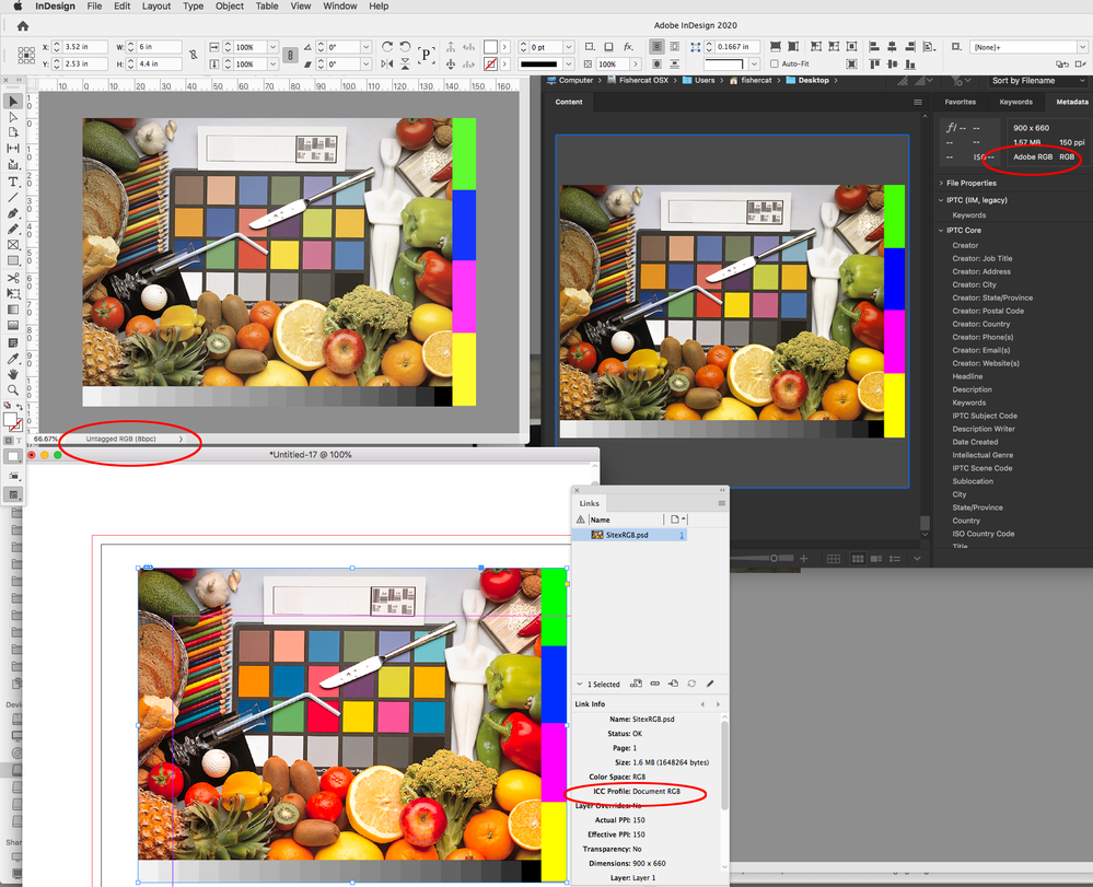

If the placed files are not saved with an embedded profile it would not be unusual to get inconsistent color previews between applications even with synchronized Color Settings. Color Settings handle the color management for future documents and don’t necessarily color manage existing docs.
Here is an RGB image saved with no profile previewing 3 different ways between PS, ID, and Bridge. Bridge displays untagged RGB images as Adobe RGB, Photoshop uses the current Color Setting’s Working Space when there is no profile embedded, and InDesign uses the containing document’s profile assignment (Edit>Assign Profiles...)
