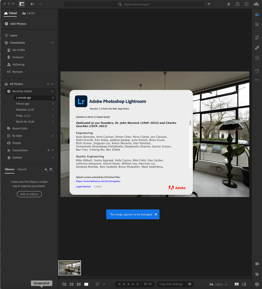

Community Beginner ,
Mar 26, 2024 Mar 26, 2024
Hi Rikk
Are you refering to Lightroom Classic (LrC) or Lightroom (Lr) when using "LR" terminology? Its the cloud version of Lightroom (Lr) (version 7.2) that has this problem when importing the exported DNG file - see belowScreenshot 2024-03-26 at 17.58.45.png

LEGEND ,
This is the Lightroom Classic forum, you are having problems reading files in Lightroom CC/Desktop?
LEGEND ,
"Are you refering to Lightroom Classic (LrC) or Lightroom (Lr) when using "LR" terminology?"
As mentioned by @Lumigraphics, this is the Lightroom Classic forum, and unless otherwise specified "Lightroom" and "LR" refer to LR Classic.
"I have tried setting Compatibility: Camera RAW 15.3 or later Lightroom develop still fails however PS works without error - the same if I export choosing "Original" ... It's the cloud version of Lightroom (Lr) (version 7.2) that has this problem when importing the exported DNG file"
Thanks for the clarification.
Using the LR Classic catalog and test images I posted above, I tested the ability of LR Desktop 7.2 to import a merged photo created by LR Classic 13.2, and I only see an error when exporting as DNG with Compatibility: Camera Raw 14.0 And Later:
Merged photo: no error
Merged photo exported as Original DNG: no error
Merged photo exported as DNG 15.3 And Later: no error
Merged photo exported as DNG 14.0 And Later: error
This is expected, since LR Classic 13.2, LR Desktop 7.2, and Camera Raw 16.2 all have the same version of the Camera Raw engine inside, and thus we'd expect them all to behave similarly. But if you have a sample merged photo that doesn't, please share it.
The export of DNG file was using LrC which is causing the issue of importing the same file back into Lr - so the issue belongs here as it appears LrC export process is the issue

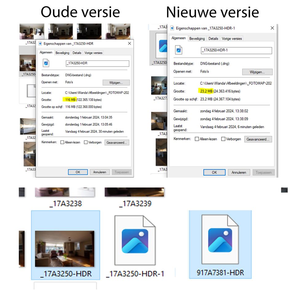

Jul 01, 2024 Jul 01, 2024
Hello, I also work independently for the real estate agent and I also have this problem, I take a lot of HDR photos for work and the merge to DNG does not go well, the file is empty, I cannot open it and it is low in MBs, which is not normal for an HDR. I work with Bridge and I have already tried everything with Lightroom, Photoshop... but it goes wrong with camera RAW... I have already submitted several reports to Adobe but I have heard nothing! I have to use the latest version because the program doesn't see my photo files... I'm slowly getting desperate 😞   Sorry is in Dutch, see difference between old version and new version
