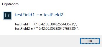

I wrote a simple test script reliably demonstrating the race condition described in my previous post. It's available as this plugin:
https://www.dropbox.com/s/1gufmz0bwubu8o9/testprefswriting.lrdevplugin.zip?dl=0
I'll bet a modest amount that this race condition accounts for many of the "corruptions" of preferences experienced by users. The programming workaround is simple in concept but difficult in practice -- identify all occurrences where there are multiple fields that should be set consistently in preferences and assign their values at once from local variables. E.g. transform

Not sure what the results mean @john but ran it for the sake of it RackMultipart2019011091427rmhy-2275ca67-79a4-494a-a38b-0fa520fbc1a7-719562280.jpg
LEGEND ,
Jan 10, 2019 Jan 10, 2019
That means it detected an inconsistency caused by the race condition.  The two values should be identical.  Technical details are provided at the top of the file "testprefswriting.lua".

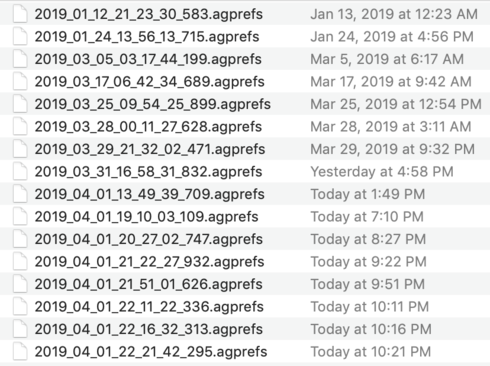

LEGEND ,
Apr 01, 2019 Apr 01, 2019
Here are the preferences snapshots my plugin has created since I started using it three months ago:
In nine years of using LR, I've only had to reset preferences once, so it's unlikely I'll have to do it again. But if I do, I've got enough of a history here to make it very likely that the culprit could be identified.
