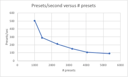

P: SDK: Severe performance in developPresetFolder:getDevelopPresets ()
Ever since LR 7.3 introduced the new develop preset format, it takes O(n^2) time for a plugin to access all of the develop presets. Some users have 5K, 10K, or 15K presets, and it can take minutes for a plugin to access all of the presets:
for _, folder in ipairs (LrApplication.developPresetFolders ()) do
    for _, preset in ipairs (folder:getDevelopPresets ()) do
Users think the plugin has crashed or hung! While having 10K presets may seem unusual, there's no excuse for LR to take minutes to return all the presets.
Here's how fast my LR / Mac OS loads presets versus the total number of presets:
Most likely, LR is storing all the presets in all the folders in a single flat list.  When the method folder:getDevelopPresets() is called, it scans the entire list for presets with a matching group.  The correct implementation is obvious: Use a hierarchical representation, with a list of folders, each folder with a list of presets.

I have experienced this performance hit as well, in writing a plugin similar to John Ellis' .
When getting all develop presets in order to loop over them and export processed versions of a selected image for each preset, the time to run the plugin does indeed go up exponentially proportional to the number of presets.
It seems to be that John has diagnosed the problem correctly here, and the hints he's found make me suspect that same thing about the presets being internally stored as a flat list.

My Export LUT plugin displays the hierarchical list of presets, letting the user select one or more to export their develop settings as LUTs (see the screenshot below).  It just needs the folder and preset names for the entire list.
Here's example code:
local t = {}
        table.insert (t, {folder = folder:getName (),
            preset = preset:getName ()})
        end
    end
I don't think the cost of reading and parsing the .xmp files is related to this issue, since it appears that the SDK is already deferring the reading until preset:getSetting() is called.  I've verified this two ways:
1. Windows Process Monitor shows that the .xmp files aren't read by the code above. They're only read when preset:getSetting() is called.
2. Timing the code above and similar code that also calls preset:getSetting() shows a 5x increase in time per preset when preset:getSetting() is called (scripts below):
Also, the cost to read and parse should be O(n), directly proportional to the number of presets, not increasing as O(n^2), as is the case with getting the entire list of folder and preset names.
This problem only surfaced in 7.3 with the new preset format shared with ACR. I'd bet money that the new implementation of folder:getDevelopPresets() scans the entire list of in-memory presets, returning those whose group (folder) is equal to folder:getName().  Another hint that suggests this: The new .xmp format stores the group name in the .xmp file itself, and the directory structure is ignored, so the UI implementation may just create a flat list of all the presets, constructing the group structure on the fly.  The UI does this correctly, the SDK not.
