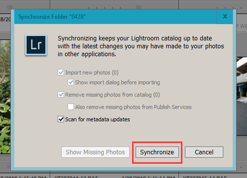

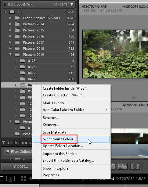

Synchronizing a folder will not do what you suggest. All that does is look for images that are NOT in the LR Classic catalog then opens the import window to show them. But that only happens after you click the Synchronize button in the Sync Folder dialog box that comes up. And there is also a Cancel button to Back Out of that.
2020-01-16 04_59_22-LR Classic V9 Catalog - Adobe Photoshop Lightroom Classic - Library.png
2020-01-16 05_01_43-LR Classic V9 Catalog - Adobe Photoshop Lightroom Classic - Library.png
So please state the exact steps you took as syncing a folder does not overwrite images and or their adjustment.

once i click the synchronize button, button from your second picture, once that process had been done, can i still go back ?
