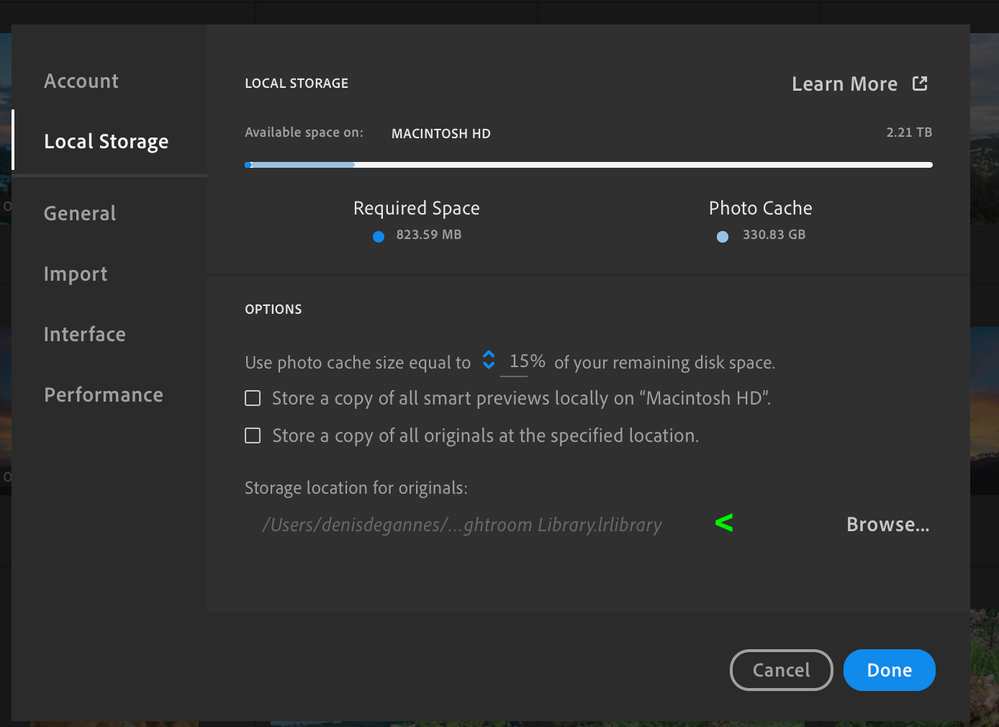

Jao, "QuoteYou just should not point them to the same storage location (which works if you simply use the defaults for those"
Just to be clear you are referring to local storage of original image files.? see the screen captures.
Screenshot 2020-07-30 at 10.38.39 AM.pngScreenshot 2020-07-30 at 10.41.05 AM.png
Regards, Denis: iMac 27” mid-2015, macOS 11.7.10 Big Sur; 2TB SSD, 24 GB Ram, GPU 2 GB; LrC 12.5,; Lr 6.5, PS 24.7,; ACR 15.5,; (also Laptop Win 11, ver 24H2, LrC 14.5.1, PS 26.10; ) Camera Oly OM-D E-M1.
Jul 30, 2020 Jul 30, 2020
Yes exactly. You should never set these to the same location.
