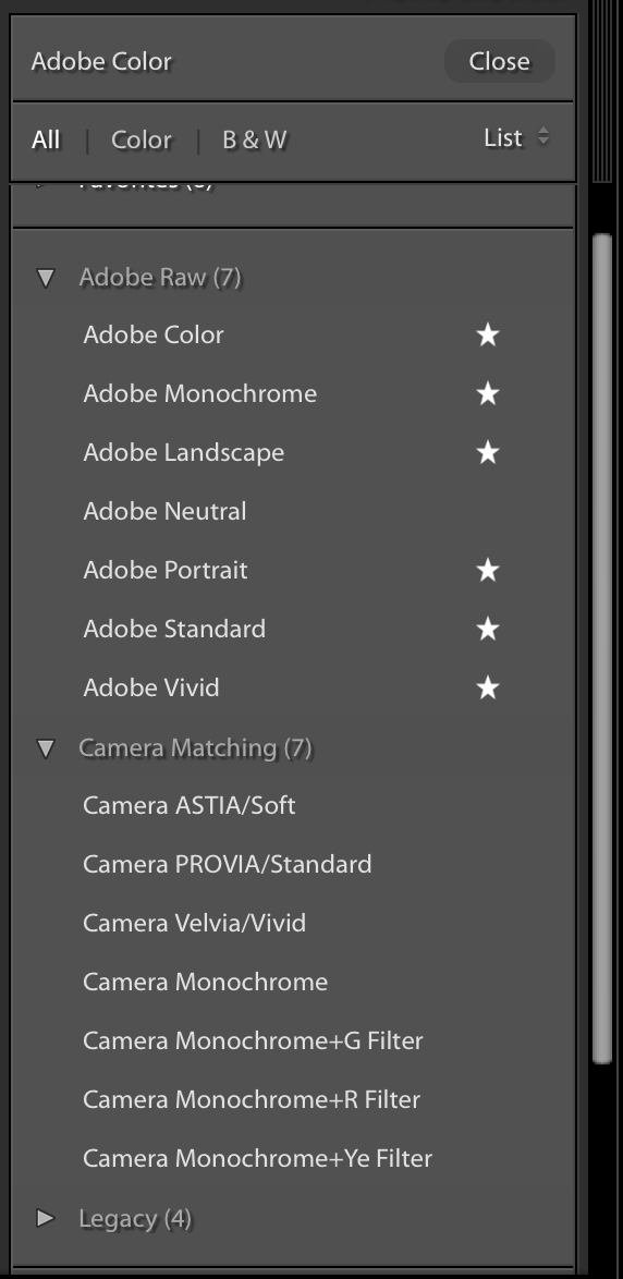

What I should have:
Two sections which are on MacBook Pro and are missing on Mac Pro:

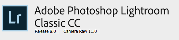

I just updated, without any results, LR to 8.0 and CameraRaw to 11.0
