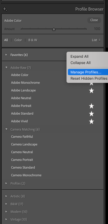

Please, do not try to copy or move application files/profiles from one location to another as it's a receipe for disater. The profiles will be installed in the correct place by the version of DNG Converter or Lightroom Classic that supports your camera.
If necessary, you can use the Manage Profiles option (right-mouse click on the panel header to open the context menu) to make visible profiles that may have been hidden.

Did you check whether the profiles are hidden because of the Profile Manager? If not, then do as I described in earlier post.

In that second screenshot, showing the profile browser, was the image selected a CR3, or a DNG?

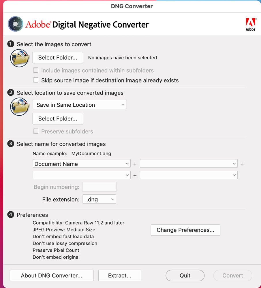

You stated, " I am presently converting my CR3 to dng externally and importing as such. This is not satisfactory. ".
Could you clarify, are you using the Adobe DNG converter, if so what version?
Also supply a screen capture showing the options you have selected for the conversion.

Aug 12, 2022 Aug 12, 2022
The Adobe DNG converter is an app that is available online from Adobe. It is a standalone application and it's only function is creating DNG file from raw images created by Digital Cameras. It gets an update every time Camera Raw is updated.
That's why I inquired about the version the author used and the preferences chosen.
