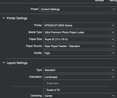

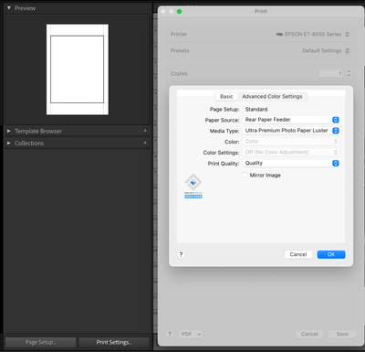

When I am in the print settings panel on the left side of the screen, I get a choice for Epson Ultra Premium Photo Paper Luster:
I make sure to save all my print settings before going further in the Print Module.
When I go to the right side and select an ICC from the drop down list in the Print Job/Profile drop down, I don't see an ICC for this paper type. (I have carefully gone through the list displayed by selecting "othere").  Selecting any of the displayed papers do not give as good a result as using the epson print layout software on an exported jpeg file of the target file and the Ultra Premium Photo Paper Luster selected in settings.  You can see that the Epson print layout software can find a configuration  as this paper type as a choice in it's settings list:
