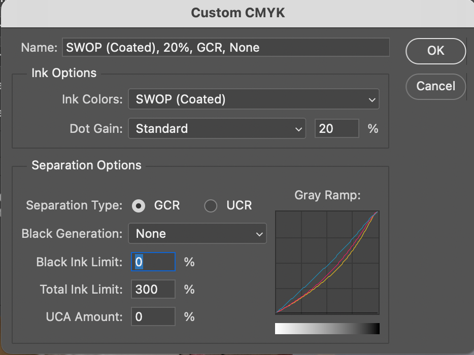

Mar 31, 2025 Mar 31, 2025
Pushing the curves around together doesn't respect the grey balance. Its more noticable in the midtones, so less noticable if you are applying a standard s-curve.
You also are potentially dealing with a hidden Tone Curve in the Camera Profile, being able to rein back unwanted Saturation is pretty cool.
Below Visually correct greyscale requires Cyan to follow a different path to Magenta and Yellow
In RGB Curves; Red is opposite to Cyan, Green is Opposite to Magenta, Blue is opposite to Yellow.
