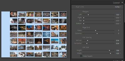

All your controls are in the Layout Panel to set 'Cell Spacing'.
And 'Margins' will add space as in this screen-clip:
A margin 'all around' (white?) where the images will not fill, would be the PRINTER margin that can only be removed by setting the Printer option for "Borderless".
