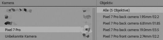

Another thing to consider is that the X-Rite software doesn't seem to be able to differentiate - at least as far as naming of the profile is concerned - between DNGs generated from the same device but from different cameras of that device (talking about a Google Pixel 7 Pro here with its four sensors and lenses = four cameras). At least it tries to save DCP profiles for all cameras under the same name (but appends a hyphen and a number if it discovers that the standard profile name is already in use).
The Adobe standard profiles that are located in C:\ProgramData\Adobe\CameraRaw\CameraProfiles\Adobe Standard on my Windows machine differentiate between those four cameras of the Pixel 7 pro and provide different DCP profiles for each of them.
That all said a freshly created ColorChecker DCP profile for my Ricoh GR - that definitely has only one sensor and one lens! - doesn't show up either in LR CC.

I think it does explain that. The XRite software probably saves the profile with specific camera information, for example with what Lightroom shows as lens information. That means that what Lightroom considers lens metadata might be what the profile uses as camera metadata. Which means that none of the profiles match the 'Pixel 7 Pro' camera metadata that Lightroom sees. Or do you mean you can't create a profile for a totally different (normal) camera either? That is not my experience.
I think Johan's explanation is correct here. The X-rite software is likely not including the correct camera metadata in the dcp file for it to be recognized by Lightroom. Not much you can do here since the passport accompanying  software is no longer being maintained it appears and hasn't been for many years. Adobe also dropped support for developing their profile creation software many years ago so it seems there is no good way to do this anymore. I guess you could use dcptool (https://dcptool.sourceforge.net/Introduction.html ) to decompile the dcp files and edit the camera descriptions to be correct and recompile them in principle. That could work but will take some tinkering.

"So again: Is there a way for me to use my own custom made DCP profiles for the Google Pixel 7 Pro's cameras?"
I don't know but I think it's likely that the XRite software does not 'see' the different cameras of that phone. This software was probably written before the first phone with multiple cameras was introduced. As a result, the DCP profile is probably not correctly linked to the phone, and that is why it does not show up in Lightroom. Just like Canon profiles won't show up when you select a Nikon raw image.

Thanks, Johan, for your reply. It's possible, but I'm not completely convinced that it is XRites fault. Phones with multiple cameras are not new, and the last update of the XRite software is from July 2021, so it's not that old. Also the EXIF info available in the DNGs should link the custom profiles automatically to the corresponding profiles as far as I understand it.
Don't forget that it's quite irritating that there are two profiles of unknown origin in the "Profiles" section of the profile browser for the Pixel 7 Pro that seemingly can't be removed by emptying the folder where custom profiles are stored. And that those profiles are somewhat generically called "Google Pixel" - no indication that they are specifically meant for the Pixel 7 Pro. Add to that the irritiating (and very off) color mappings of the Adobe Standard and "Google Embedded" profiles also available for it - all that makes for a less than enjoyable experience handling the Pixel's DNGs with Adobe products.
