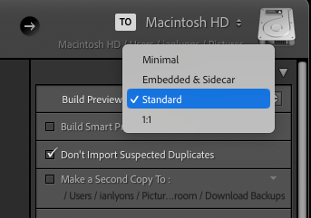

You've imported the photos using the 'Embedded & Sidecar' option, which means that the Library previews are based on the JPEG preview embedded by your camera. However, when you switch to the Develop module it's the Adobe colour rendering that's used. To get a better match between the two modules you should select all of the images (Library module Grid view), then choose 'Build Standard-Sized Previews' from the Library > Previews menu.
In future, I suggest you choose the 'Standard' preview option in the 'Import' window (see below screenshot)

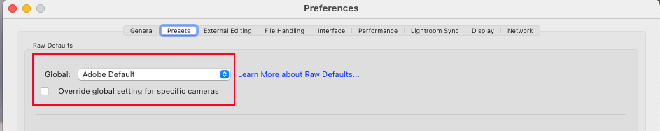

There should be little, if any, difference between the embedded preview and Lightroom's own previews. If you're seeing a big difference, then first check that you're not applying a Develop preset during the import process or that you haven't changed your Camera Defaults in Lightroom. I've attached screenshots below that you may find helpful.
If above isn't the reason for your drak images, then it may be due other factors. For example, some lenses produce significant vignetting (darkening of corners). If you haven't enabled a lens profile, then try this as may well help with the dark images you mention. That being said, if your camera is of the mirrorless type, the lens profiles are usually applied automtically and can't be enabled/disabled by the user.
