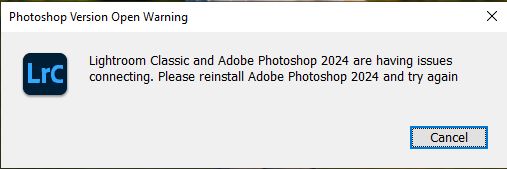

I get the prompt that Lightroom and Photoshop are having issues connecting. I've tried resetting the preferences of Lightroom Classic and photoshop. As well I have re-installed them both through the Creative Cloud App.
Still doesn't work 😞
Any other ideas out there?
