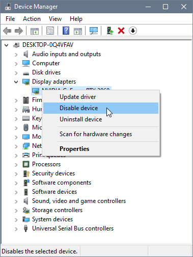

Adattatore n. 2: Fornitore : 8086
Dispositivo : 4680
Sottosistema : d0001458
Revisione : c
Memoria video : 80
This seems to be an integrated GPU – Intel UHD Graphics 770.
Adobe software does not work well with dual GPUs. It can cause issues like the ones you are describing, so try to disable it.
Go to Control panel > Device manager > Display adapters, right click Intel UHD Graphics 770, and choose disable.

Thanks, I'll give it another try with this method.
