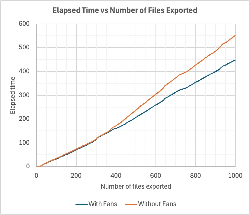

Very interesting. I observed the same behavior on my Macbook M2 Max exporting 1000 raws from and to the internal SSD:
(See the attached spreadsheet.)
After 364 files, the Mac throttled back on the GPU and performance cores. (Maybe the GPU was throttled and the performance cores were limited by that; or maybe the performance cores were throttled, and the GPU limited by that; or maybe both were throttled.)
Overall, keeping the fans on increased the rate of export by 23%.  But just comparing the time when the GPU and cores were throttled (after the first 364 files), the rate of export was 41% faster with the fans on.
I don't think this is under the direct control of LR (or any typical app). It's the operating system and firmware that decide when to throttle.

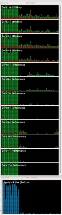

2. Select several dozen raws and start an export.  After it's been running for 30 seconds or more, post a screenshot of Activity Monitor showing CPU History and GPU History, e.g.
