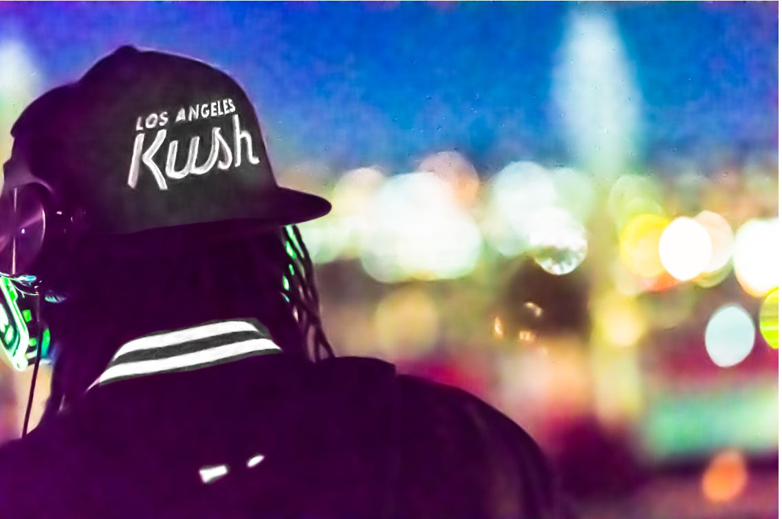

Greetings,
I'm trying to export some photos for a client but they are coming out very blurry and pixelated compared to the Lightroom image. I am stylizing them heavily but can't quiet figure out what is causing this in the export. I have attached photos of the image in lightroom, the export, and the export settings... any help would be very much appreciated.

Thank you for the reply. That setting was leftover from a previous project. I've since unchecked the box altogether. I'm ultimately hoping to get the image to export as close as possible to the look in Develop module. The export seems to be emphasizing the adjustment layers particular on the stripes of the collar as well as the heavy pixellation in the sky.

Regardless, I exported a TIFF and it appears exactly like the JPEG. To answer your question, yes, I took the first screenshot from the Develop module with the zoom at 1:1.
The first image I posted is Develop module 1:1. The second is the exported JPEG. I've opened it with multiple programs as well and they all look the same... officially, "jacked up."
I'm really not trying to get into a war of words here... simply looking for any guidance.
Below is the screenshot of the TIFF

Then it is what it is; probably your processing of the raw. Officially, "jacked up."
What happens in DEVELOP at 1:1 if GPU settings in preference are off?
Recalibrate the display, could be a corrupted display profile if that doesn't work. Do NOT build a V4 spec ICC display profile.
