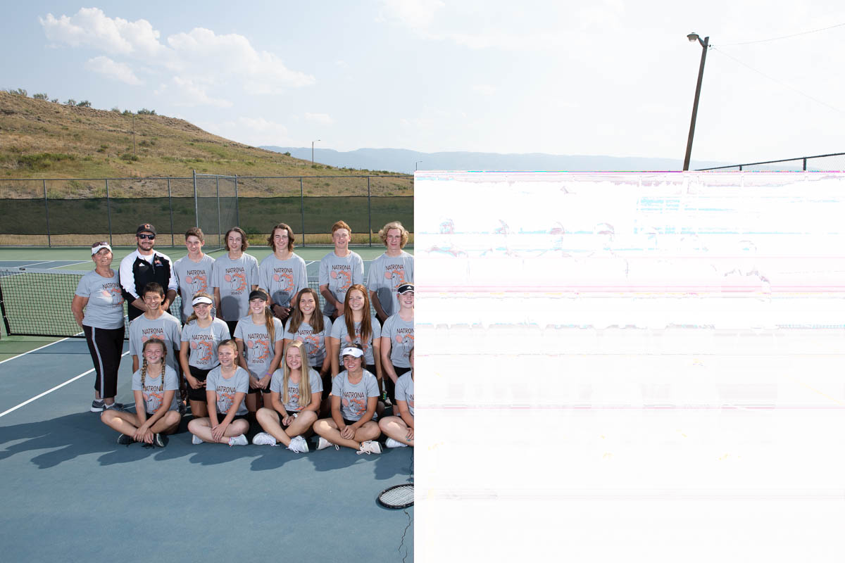

Are there any known issues with .cr2 files from a 5d M4. I have random files showing up bad and unusable. Just wondering if it is camera or computer or sd and cf card. Canon said possibly Sensor, B&H said nothing wrong with camera and that LR is not compatible with raw files from the 5d M4 which this is the first I've heard that. Also said I need to use .dng if using LR. Also I don't see the issue with the files while viewing on the LCD screen on camera. Seems to only be when importing to LR. My camera is 15ish days old. Wondering if I should just send back and exchange or what to do. thanks.

So here is what I have done up to this point. I have tried importing them and converting to .dng on import. I shoot so both cards mirrored so I tried the other card. They don't show up as bad on either card on the LCD or in the initial import view when you are choosing the options to import them in LR. When I put the cards back in the camera they show fine still when viewing in the back of the camera. Weirdest thing.
I use my sd card slot in my mac laptop...and I use a card reader for my cf card having the same issue with both options on both cards. The files that are bad are the same always.

If the same exact "random" files are showing up bad on both the CF and SD card it would indicate a problem with the camera. It's highly unlikely during import the CF and SD cards would "randomly" corrupt the same exact file numbers due to a system related issue.
Having said that I would follow 's suggestion and try directly importing the files using the camera's USB port. Copy the files directly to a folder using Mac Finder or Windows Explorer and then try importing the files in that folder into LR using 'Add.' You want to keep the process as simple as possible to determine the point of failure. If the same exact files are still showing up bad on both the CF and SD card then you have your answer.

yeah..any which way I try to import these pictures, the same files keep coming up bad.

Ok. so after a round robbin of conversation with the company I use for my storage devices, Adobe cust. support, and Canon I have determined it is a bad sensor on the camera and will be returning the camera.
Adobe told me there is a known issue with dual pixel raw photos and gave me a site for a work around. Link posted here.
I've never used Canon's software before and also never heard it recommended to work around issues. Never the less decided to try it so I downloaded it and opened the files only to find they have the same issue.
Called Canon sent them both .cr2 files and .jpg files that were bad and they determined I have a bad sensor. Good thing this is a brand new camera so I can exchange it.
