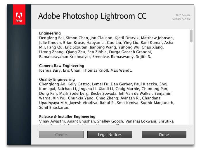

I saw there was an update to Lightroom 2015.10 so I checked updates but nothing was showing.
I decided to  Un-Install Lightroom from the Mac and then sign out and back into Creative Cloud and install Lightroom.
Lightroom installed but now I have version 2015 which is older than when I un-installed. How can this be ?
How can I get CC2015.10 as I am going round in circles

Quote "I decided to  Un-Install Lightroom from the Mac and then sign out and back into Creative Cloud and install Lightroom."
There was no need for you to do this the full Lightroom installation is LR 6.0/ Lightroom CC 2015.0 all the updates 2015.1 through 2015.10 are update patches and make the necessary changes to the full installation. Therefore because you uninstalled the earlier application the Application Manager had to install the full application i.e. 2015.0 first and then you need to cho

You can get the 6.10/2105.10 patch from the direct downloads.
https://helpx.adobe.com/lightroom/kb/lightroom-downloads.html
There was no need for you to do this the full Lightroom installation is LR 6.0/ Lightroom CC 2015.0 all the updates 2015.1 through 2015.10 are update patches and make the necessary changes to the full installation. Therefore because you uninstalled the earlier application the Application Manager had to install the full application i.e. 2015.0 first and then you need to choose the appropriate update patch to update the application to the version you wish.

Many thanks, I understand the process now and everything is working again
