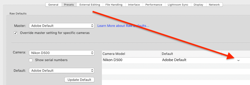

"I can create the profile, I can create the preset, I can use the preset on as many images as I'd like (as far as I can tell), but I CAN'T assign the preset in preferences to be a camera-model-specific default import preset.  I don't SEE anything in the Lightroom information that says I CAN'T do this, but it appears I can't."
When I first tried this just now, I too couldn't see the preset with the camera-specific profile in the Default drop-down menu in Preferences. So I went to file a bug report, but now I can't reproduce the behavior, after 20 minutes of trying. There were multiple restarts of LR throughout this, so maybe there's a glitch that goes away after restart (not uncommon for LR).  For good measure, try rebooting your computer.
If you can reliably reproduce the problem, make a screen recording from start to finish of making the profile in ACR, creating the preset in LR, then seeing that preset not appear in Preferences.  That will provide all the necessary details for an actionable bug report. (I'm afraid that without the screen recording, Adobe developers won't be able to reproduce the problem).
When I first experienced the bug, I did notice a workaround.  Create a default setting for the camera with Adobe Default. Then click the dropdown menu on the right-end of the default -- when I did that, the camera-specific preset magically appeared:

Thanks for the reply...
I just tried what you did and got the same result.  Didn't work.  Closed and re-opened LR.  Changed to Adobe default.  Didn't work trying to find (couldn't see) my preset.  Closed and re-opened LR.  D500 now had Adobe default.  Tried the dropdown under where you put the camera - right above the "Update Default" button, nothing.  Went to the OTHER drop down to the right of the camera model and it WAS there.  And once it WAS there in that dropdown it showed up in the OTHER dropdown...  I'm not sure if it was the MULTIPLE restarts, the computer reboot didn't do anything, or just me getting up and doing the Hokey Pokey and turning myself around, but at the MOMENT the preset I created is visible.  Now I'll try creating the REAL one again and see if I can get THAT one in as the default...
