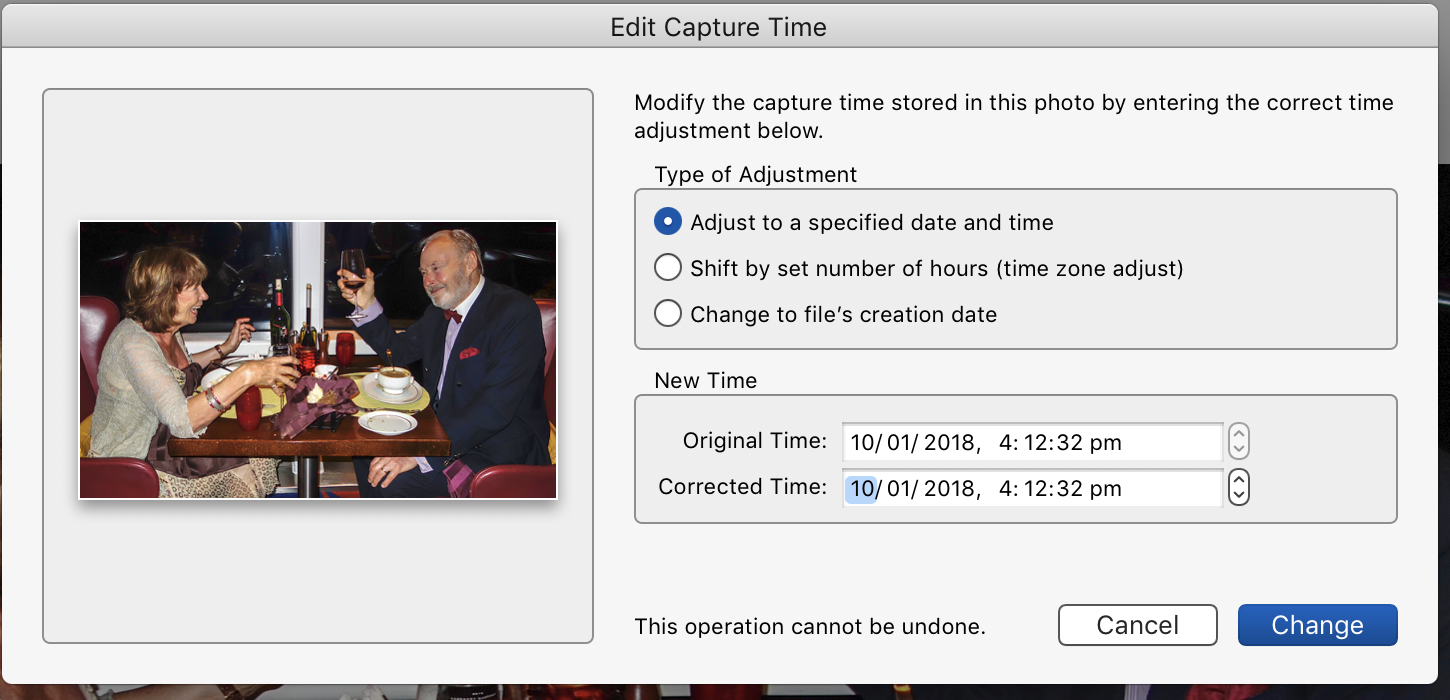

Sorry dj..please look at the screen captures showing a Capture Date of 10 January 2018 rather than what I know to be a few years ago.
I tried clicking on the button on the right of Capture time and also on Capture Date but without success. (Using "Change To files creation date")

I referred to a menu command in my previous message.
Participant ,
Jan 22, 2018 Jan 22, 2018
The EDIT CAPTURE TIME window states "Modify the capture time stored in this photo by entering the correct time adjustments below"
I can't enter time adjustment as I don’t know the correct date on which the photo was created. That’s the information I hoped would be given by Lightroom.

LEGEND ,
This doesn't make sense to me. You want the software to figure out what date the photo was taken?

LEGEND ,
If the date is not in the photo file, then the software cannot help.
Where did this TIF file come from, anyway? What is the source, camera or scanner? If camera, how did it get turned into a TIF?

LEGEND ,
Some software turned the camera photo from a JPG or RAW, into a TIF. If you can figure that out and find the original (JPG or RAW), the date the photo was taken should be in there.
