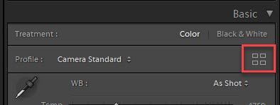

You will need to close and then reopen LR, which will load the new camera profile. Next in the Develop module Basic panel click on the four squares icon next to 'Profile, which is at the top of the Basic panel. Then scroll down the list of camera profiles to the 'Profiles' tab. Click on the Nikon D7000 Underwater WB Correction profile and then on the star icon to set it as a Favorite so it will apear in the profile list.
