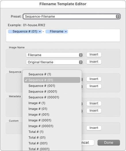

Select photos, choose Library > Rename Photo, and build a filename template that includes a sequence token at the beginning, so that when sorted by Filename, the numbers at the beginning of the filenames determine the sort order. It will number them based on the current order, so be sure to set a custom order before batch renaming. If you save the template as a filename preset, you can re-use it in the future to rename more batches of photos.
In the example below, the file’s original name was house.RW2, and the filename template is going to add a two-digit sequence number and a hyphen to the beginning of the filename.
