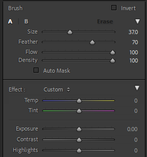

You may have pressed a number key while using the brush: for example typing 1 would set 10% Flow, which applies the brush only very weakly. Typing 9 sets 90% Flow, typing 0 sets 100%. Or if you type two numbers quickly you can set an exact % directly. e.g. "18".

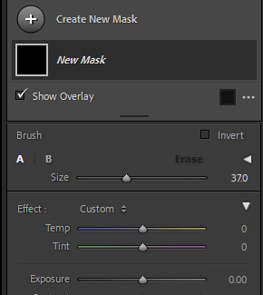

If in the local adjustments panel you only see brush Size, like this:
then click the triangular arrow button opposite A and B, to open that part up:
and there is another triangular button opposte "Effect" which opens and closes the local adjustments sliders as shown.

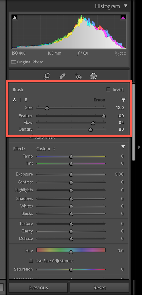

Assuming you are working with a mask, you can adjust the flow and density.
-see attached-
