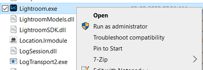

Do you see Lightroom Classic in the Task Manager? Where is the catalog stored at the moment? In the internal drive or the external drive?
Try these steps:
  • Go to Task manager > Processes > look for Lightroom Classic.exe > End task/force quit.
  • Go to the Lightroom Classic's installation folder. (C:\Program Files\Adobe\Adobe Lightroom Classic - by default)
  • Right-click on Lightroom.exe & select 'Run as administrator'
You can also try pressing the ALT key at launch & select 'Create new catalog' & let me know how it goes. Thanks!
